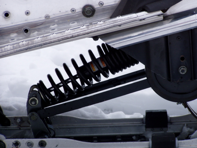

Now for the suspension performance, there are some problems which I anticipated, just didn't get around to correcting yet. With the increased leverage against the shocks, there is a lower shock travel with respect to the suspension travel. This means that one of two things has to be done; either the shocks need to be about twice as stiff, or they have to be given back full travel. I opt for the latter by remounting the front of the shock to a pivot on the rail, similar to this: http://www.ty4stroke.com/download.php?id=9926 , but shorter, and with the relay crossed over the shock instead of running parallel with it.

I can't say that it was difficult, it was definitely time consuming, but if you plan every move before you cut or weld, then there shouldn't be any problems. On top of that, its always harder to design the modification than to copy it. So I say that as long as you're patient, you'll have no trouble.
