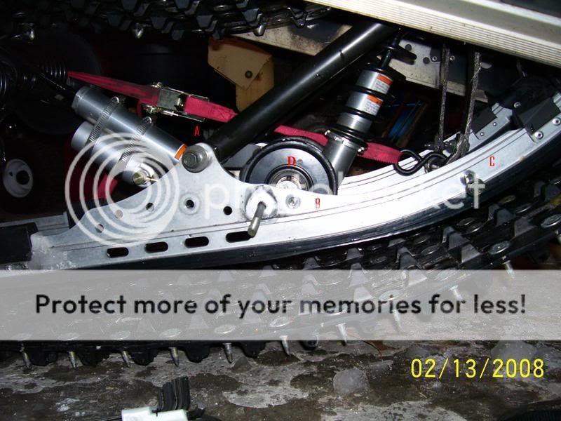

OK.... after looking at it, fighting with it, swearing at it, beating on it....it dawned on me. This is really easy if I think it through.
Steps below
1. Raise front of sled
2. Raise rear of sled
3. Back off track tension 8 turns
4. Use ratchet strap to compress skid
5. Disconnect rear of skid and pull down
6. Make sure rear is raised enough to work comfortably.
7. Remove torsion spring mount
8. Remove bolt which holds shaft of idler system - B
9. Back out set screw from the block - D
10. Remove front bolt holding shaft which limiter straps are connected to - C
11. Remove bolt where front diagnol is attached - A
12. Lift skid by hand and gently pull rails from shafts
13. Grab ilder wheel and block and easily slide out.
I wish I knew the proper terms or even how to edit my pic to add letters to correspond with the directions - seriously this took a few minutes.

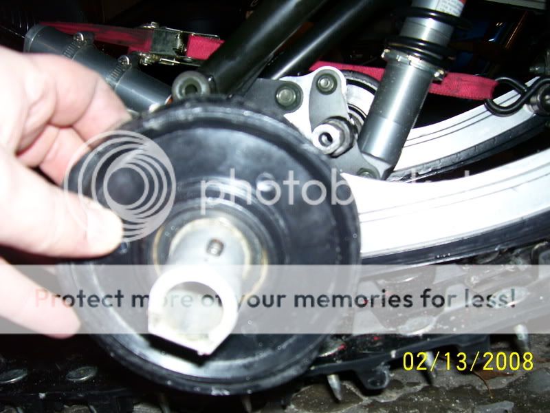

Torn up wheel slid off shaft
