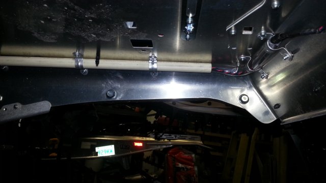

Well, this is what I've done to keep the wires safe under the tunnel. I have the split wire loom inside the pex tube, thought the red matched my 11 XTX well , lol!

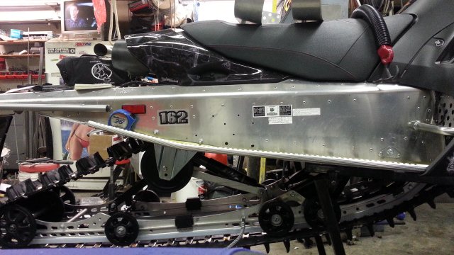

I relocated my light after seeing how good it looked on a few others on this site. I ran the wiring along the fuel tank as normal, and had it come through the tunnel at the start of the aluminum shroud that the seat is on. I cable tied a piece of split rubber fuel line around the wires where it went through the tunnel. Underneath, I riveted on two three to four inch sections of aluminum square tube from an old toneau cover. I wrapped the rest of the wiring in plastic sheathing and ran it through the square tubes. Where the harness and light connect, I slid a piece of 1" clear vinyl tubing over the connection and cable tied that to the tunnel guard way in the back. I don't have the best pic of the setup as it wasn't completely finished but here's a look . I also fabbed up my own tunnel block off. The pic doesnt show it, but it is all riveted in place. I was still doing a little trim work when I snapped this.
