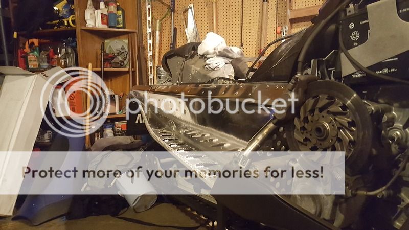

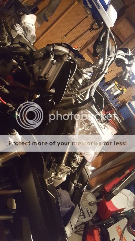

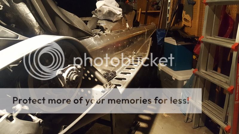

Hi guys bought my nytro last year and rode through that terrible winter made 8 trips to the up because minneaota sucked. My freinds and i put on 1600 miles. In those 1600 miles i found a few things i did not like about the sled. We ride pretty hard but slow enough to stay safe. I found that the sled pushed bad in the corners. I changed the shocks up and tightened up the front straps. Also added some 6 and 8 inch carbides to my tuner skis which all helped but wasnt as good as my srx still.
This year i am doing some C&A razor skis with some 8 inch shapers. Oft relocate, pcv, and a clutch and wrap and polishing up the tunnel. So far i have the skis on and the oft in and one side of the tunnel polished. Pcv should be in this week.
Still trying to decide what clutch to get and who to use for the map for the pcv. Any recommendations would be helpful.
Dull side
Shiny side
Relocate

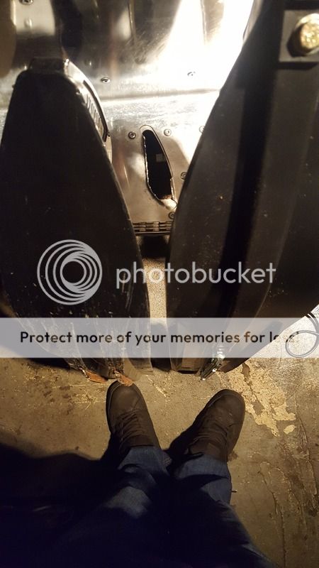

Old then new skis
