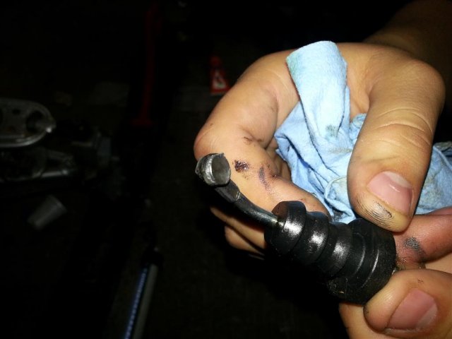

I have a small rare earth magnet JB Welded to the dipstick. Works great to trap these particles. I still change it annually also to remove any moisture.

I want to do this on both of my Vectors. Could you please post a picture of where you mounted it in the stick and also which JB Weld did you use? Where did you get the magnet from and is it special in any way. Thanks!

Here's a clear shot of the magnet on the dipstick and what it caught. I used regular JB Weld as the JB Quick is not as strong. I also scratched up the dipstick so it has something rough to stick on. You can also see the magnet a bit on the outside (hex) end of the drain plug and what it caught. Pretty incredible.
I got these from Princess Auto in Canada. Not sure where you could get these in the US. Hardware stores or industrial supply stores. They're about 1/4" diameter. They're pretty strong and will stick to the outside of the drain plug. Amazon has them.
