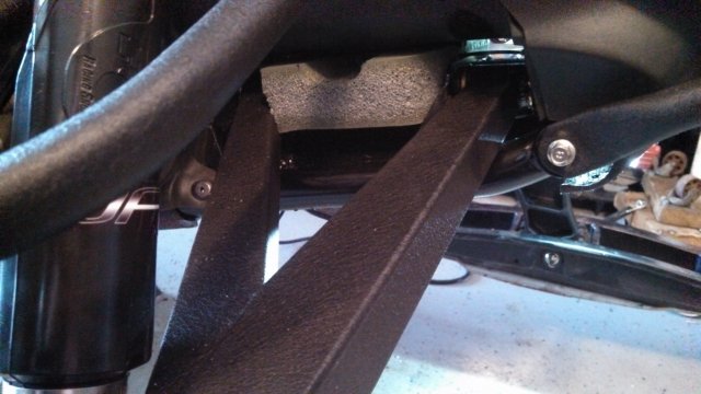

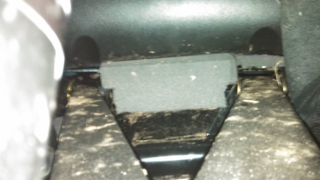

Teddy here is a picture showing what OTM is talking about on the foam block off
Now I have replaced this open cell foam with a closed cell foam yoga block ($9 on amazon). You want to use the closed cell so it will not absorb water and cause it to swell. I have also cut two smaller pieces to slide above the A-arm connection points. I'll try to get a picture tonight for you.
I also went with the long skid plate version and believe it was the better option IMOA.
