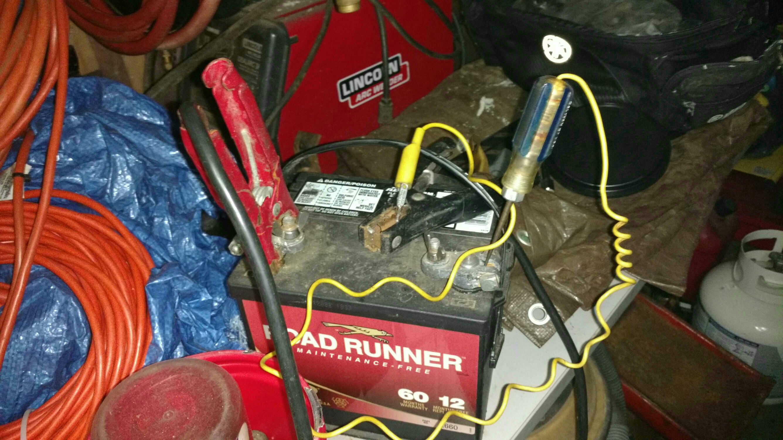

Connect your battery like normal remove the negative cable.make the connection between the battery and the cable you just removed with a test light. In the picture you will have to imagine that the leads from the battery charger are your positive and negative on the machine.n ow even though there is a small draw because the battery charger has a volt gauge the light won't be on too small of a draw to matter. But with 2amps from the battery charger you can start to see a glow. If it glows you have to much draw.
