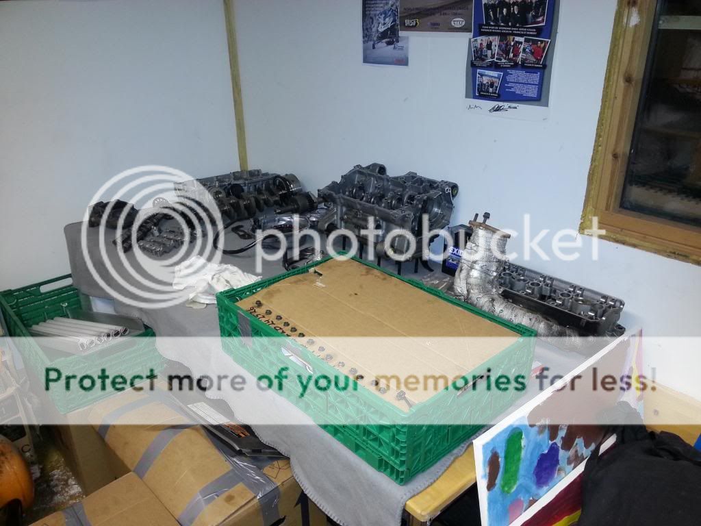

The sled encountered a cross pin failure at the #4 piston.
The Wiseco 2006 cross pin failed causing damage to the piston, Carrillo rod and all 5 valves, it also caused damage to the cylinder and Block. I'm thinking of getting hold of a used engine or a New cylinder Block.
Anyone having one laying around?

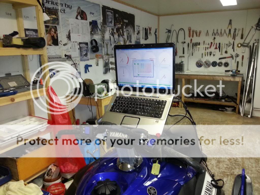

This sled was in to adjust boost pressure.
The sled was Down on boost, only 10 lbs.
I adjusted up the pressure in the MCX ECU boost map and took the sled for a spin.
No change in boost pressure.

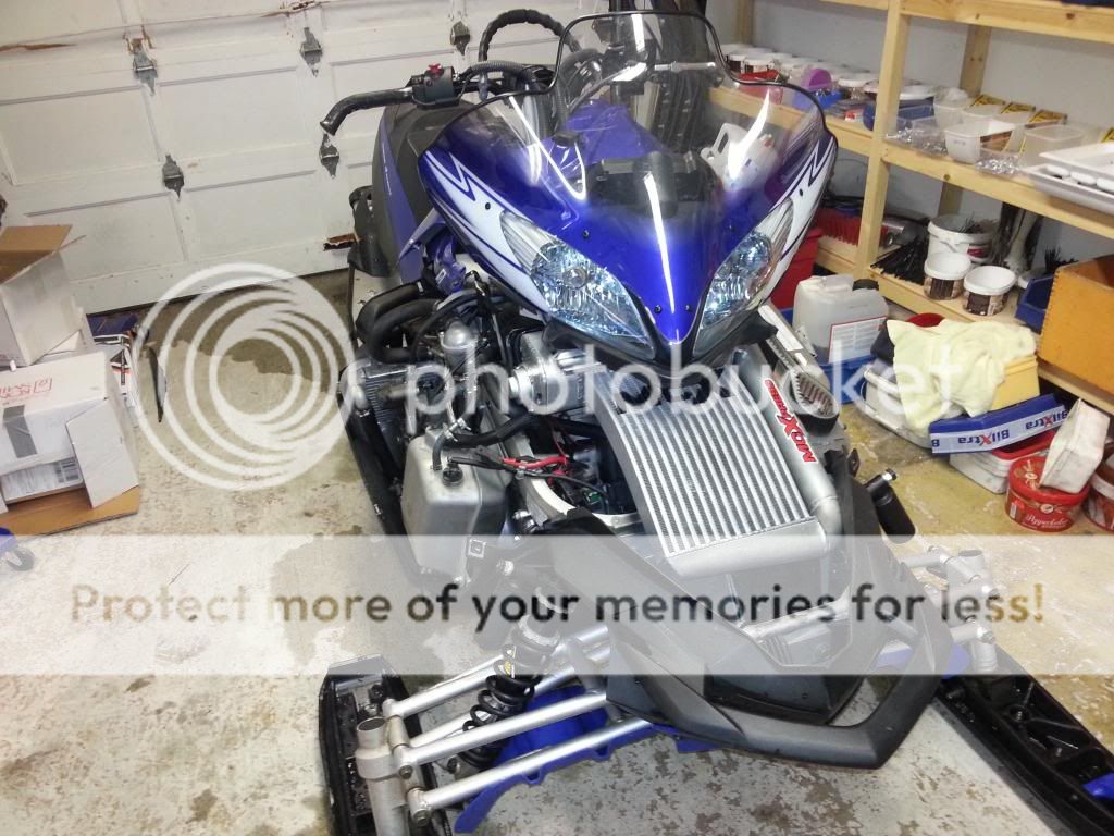

We figured what it was, the fuel rail had jumped off the engine slightly leaking boost pressure.
The intercooler came off and then the fuel rail. Reinstalled everything and the boost leak and smell gasoline was gone.

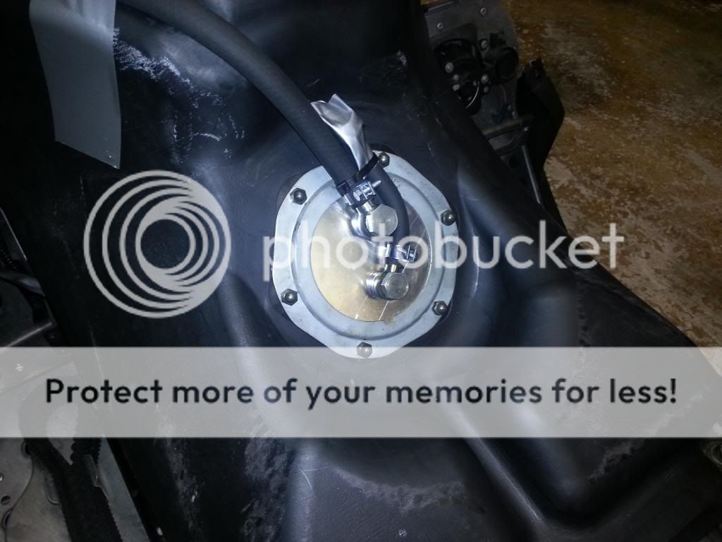

The NeXT sled was in for a fuel system Upgrade. It's a Apex With MCX260 we're upgrading to MCX290.
The Stock fuel pump is not up to the task and has to be removed.
A New high capacity fuel pump is going in to feed the engine the fuel it needs at 290 HP.
The fuel pump installed.
The Stock fuel pump has been removed.
It's replaced by an adapter.
The Stock fuel pickup is removed from the Stock fuel pump Assembly and installed on the fuel pickup adaptor.
The old Stock fuel pump has been removed.
