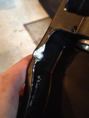

It may not actually rub. To install the lower a-arm into the spindle you have to use a c-clamp of some sort (since the lower "ball joint" is tapered into that bushing you see) or the ball joint will just continue to turn and not get tight. I know the first one I did I marred up the spindle like that without realizing it was happening.
Tyloooor
wow, haven't seen or read anything about a c-clamp... is there install instructions out there?
