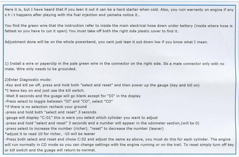

At WOT while climbing, the sled seems to bog. I was told I am probably running rich on the top end because of the new exhaust. The sled also has a hesitation at the bottom end now. Apparently you can adjust the EFI through the sled controls. Can anyone tell me where to find how to get into this controller. It has something to do with attaching a ground wire at the front of the sled. I have done searchs but can't find anything.

Rx1M5
I think a guy is going to need to do more than adjust the CO's which is what the wire thing does. I think you will need to go to a new map from a new controller like a Power commander or something. I'm kind of waiting to see if somebody comes up with something before I jump in.

flainx
Thanks for finding the instructions.
RX1M5
You may be right. I was told to give this a try as it is an cheap way of possably fixing my problem. I will try it next weekend and see what happens.
