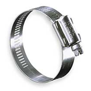

I was able to get mine out and new one back in after just taking off the air box by clamping one of these guys on the filter and taping a screw driver with a hammer to turn the filter.
Very Nice thinking outside the box :)

This is what i meant to clear it up if needed. I was changing my filter today thought i should take a picture. All it takes is a few taps to loosen it up and then remove the clamp and turn by hand.

Very nice, that will come in handy until I get the K&N filter on there. Does the bolt on the hose clamp clear the part on the left of the picture or do you loosen it and start over?
Yea it clears the parts on the left but does not clear on the right. However by the time you get it around the there you can loosen it by hand. I used a solid part of metal and the screw driver to pry the clamp off the top of the filter and did the rest by hand.
