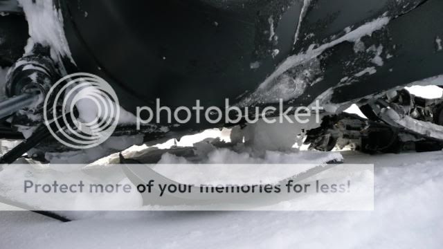

This is pulled from my mileage thread last year:
Here’s the floatation plate…
The front of it is held on by clamps…not really that good in my opinion…but Yamaha’s other skid plates are the same install around the bumper, like on my phazer.
So I looked at it thinking, yeah…it will accumulate snow in the front A-arms, and it will likely build-up snow and ice between the belly pan and the skid plate itself, but the one piece design of it may not only prevent snow from coming into the engine area but it really does look like it will help in floatation when carving and in deep snow.
What’s the verdict?
The saga continues…
Yesterday I went for a 235 km (147mi) ride with Bruce. The big lakes are like cement right now but the wind protected bays and ponds are pure powder gold.
After 500 km’s of testing with the Yamaha Floatation Plate, it too receives a failing grade.
Why? Here’s why:
The damned thing fell off!!
So what’s the problem? How about the age old snow and ice buildup. Am I providing enough proof that this is a major problem with these sleds?
We were powder riding, I stopped to talk to Bruce and he pointed out that my skid plate was falling off. There was so much snow and ice build-up between the belly pan and the skid plate that it pushed the skid plate right off in a variety of ways…
On a couple of bolts, even with washers that I had installed, they punched right through the skid plate from ice buildup. On a couple of others, you know those threaded circlips I showed you? It took them right off the sled, space, bolt, circlip and all – still attached to the skid plate. In other spots, the clamps I showed you in the front? They busted clean off!!
Like come on – this is crazy! Obviously I’ll be going to get my money back and return the skid plate.
It was hanging by one clamp when we seen it, so I removed the clamp and put the skid plate on the back of the sled. I thought I could make the thing get air!
