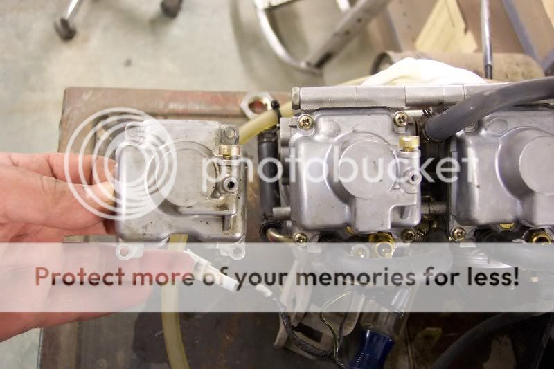

Old design on the left and new design on the right.
From the 2004 tech update book. "The float bowl chamber shape and main jet holder are changed to improve fuel delivery during steep hill climbing angles."

thanks for the pics,my dealer called yamaha and got a set

Or hard accleration LOL!
I didnt know they changed the design of the bowls I thought there was just a oring installed. Now I know!
