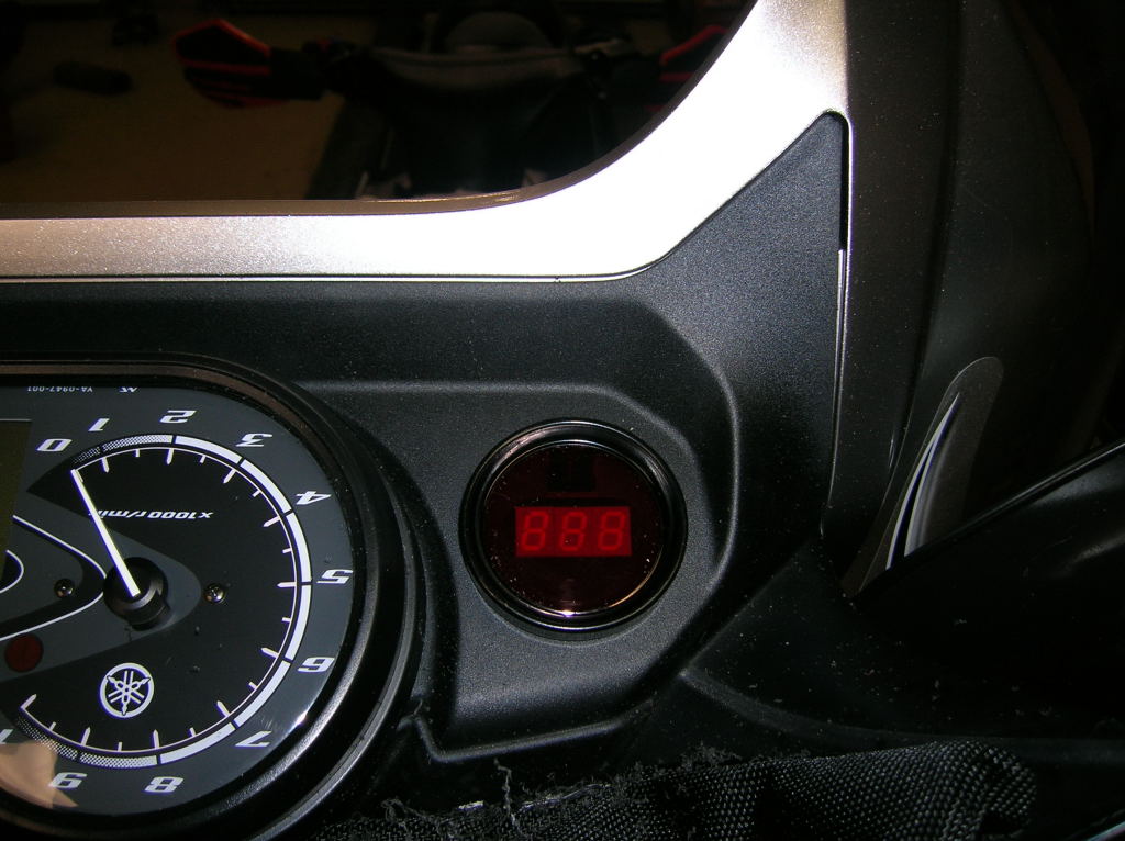

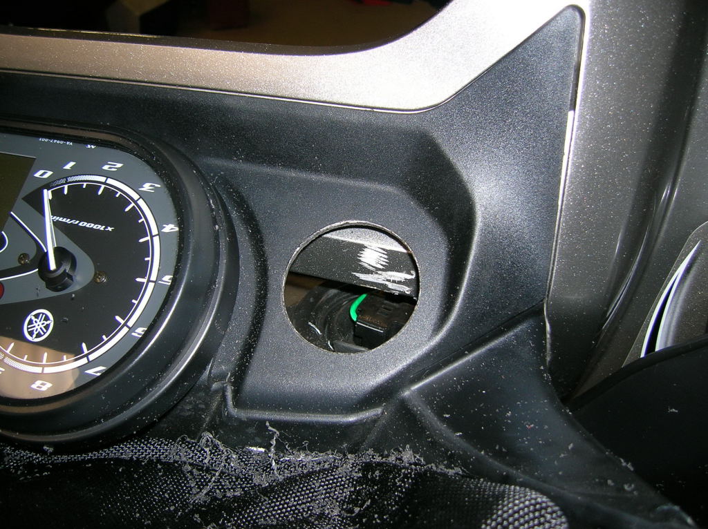

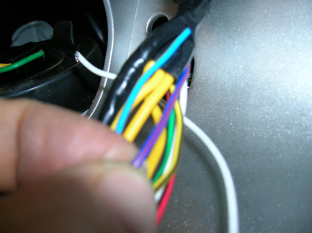

Her is what I did .I cut the 2" hole in the dash with the whole saw . I sealed the back of gauge with silicone to make sure water did not get in.I programmed gage to flash at 215 degrees . This must be done before install. as you will not have access to it after.I installed the gauge into dash. next step is to splice into wires that feed the instrument panel.I wired into the hot feed and ground at this point. Then you need one wire to go to the sender and a ground.I removed the some coolant and then Cut the splice into the hose that comes out from the motor. I installed splice and sending unit. The photo's tell the story, There was some question of this gauge holding up the the effects of the winter conditions so before I splice the hose ,I powered The gauge and put 120 miles on the sled . There didn't seem to be any issues with the snow cover the gauge or the bumps.Hope this helps

The gauge comes with 4 wires (as long as you got the one that has no memory)One goes to the sending unit one goes to power and one goes to ground. The last one suppossed to go to a switched light, But we dont have one . What it does is dimms the display so it not so bright. I left it unhooked,The result is its a little brigher at night than in the day. They also use this wire for programming at what temp you like it to flash at.you could put a switch in for that wire. The sending unit has a 1/8 NPT tread . The sending unit sticks out a little over 1/2 inch from the treads.If you are hooking up to a vector or rage the big brown wire is the gound and the hot wire is what the service book calls blue and red, But its more violet with a redish line. here is 2 more photos these are right beweent the headlight so the short leads that come with the gauge will reach.yamaha1 said:Looks good S-C.I have an ice blue cyberdyne gauge on order. The only thing that I still have questions on is the wiring. How exactly did you wire it? Which wires did you splice into (color and location)? How many wires need to get hooked up? Positive, ground, and one wire from sending unit to gauge correct?
