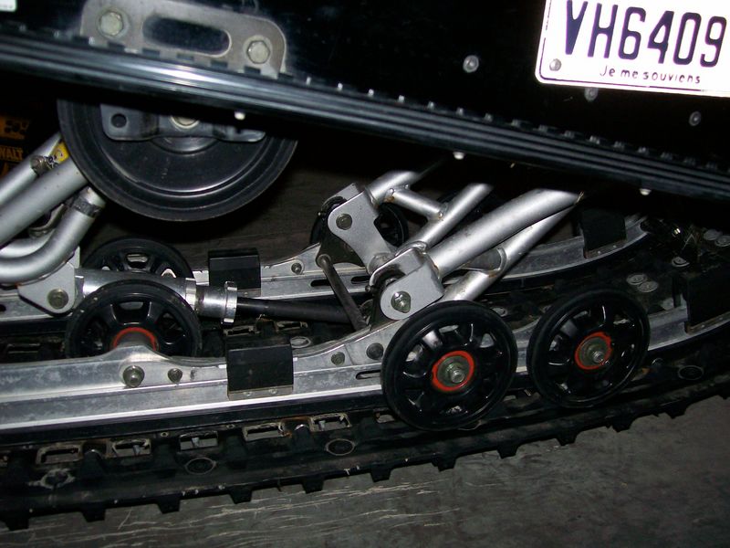

I run the Yamaha aftermarket wheels,very please with these wheels and the got 6005 replaceable bearing.

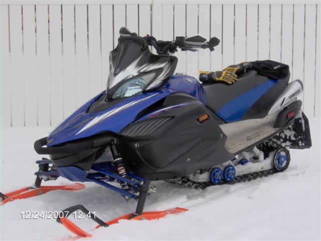

I run the Yamaha aftermarket spoked wheels.No problems

The stock wheels were warped and the bearings were shot.The spoked ones I bought have replaceable bearings.

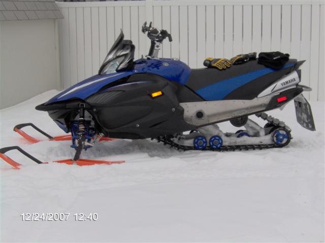

I was going to put the bigger wheels on from polaris but did alot of research on the subject and found that people were having bigger problems with the bigger wheels like rails cracking and other problems.
