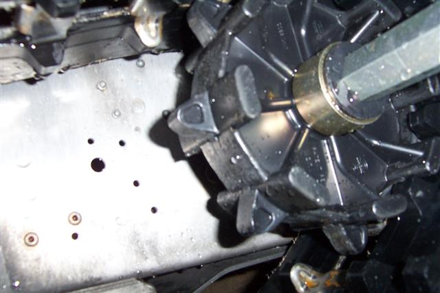

Kachess
Kachess
tundra
Mine was dooing this too when i put my new track on, driver was year old, (4000km) . They made a clunking noise when decelerating, that was track vs extro fighting together.About 100 km later and tighttening track a bit, after each run, all weird sound is gone except for my chassis that make a cracking noise but this is another story.
My driver look way more worst than Kaschess.

Thanks for the pics Kachess! The other night I ground off the drive side of the teeth. Last night I ground off the trailing side of the teeth. The noise has disappeared!! I hope the teeth still function properly by pulling the track because I needed to grind quite a bit away from both sides. The track would ride up both forward and reverse.
