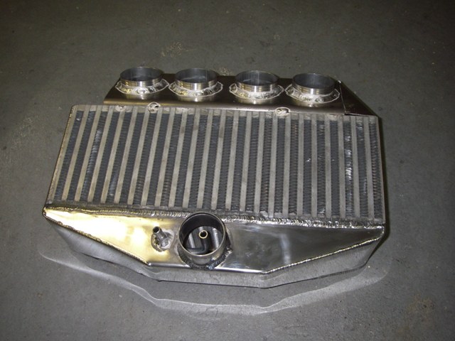

I think everyone is having a hard time getting over the typical thought of the bender pitot. A pitot is a tube that faces instream of a flow. The powderlites kit uses one and so does the boomdocker. So do jets to measure airspeed. The thought of a bender tube with a jet on it is what the yamaha guys think when they hear pitot.
If you pull ur charge tube off and look down the pipe of the intercooler there will be a tube in the middle of it facing back towards the turbo which is the pitot tube.. If it doesn't take a pic to prove me wrong.

my charge tube is hollow with only a hole for the blow off valve .this is a front mount powderlites kit on my rx1 .mine doesnt have a pitot like you are talking about.so the powderlites kit dont have it.
dirk_03
rx1 fern
i see what you mean now .mine has that but i dont have a jet or anything in it.mine is teed into my fpr and carbs .thanks for verifying that.
