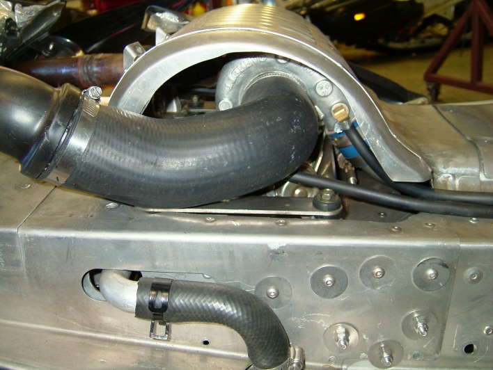

The RU1770 sounds right to me. All you really need to know is the mtg dia., filter OD and filter length. Depending on your turbo sytem and how you mount it you can run just about anything. Remember to get a silicone impregnated outer skin to help keep moisture from being introduced to the turbo intake and it helps prevent it from iceing up (just knock the snow and ice off with your hand)
