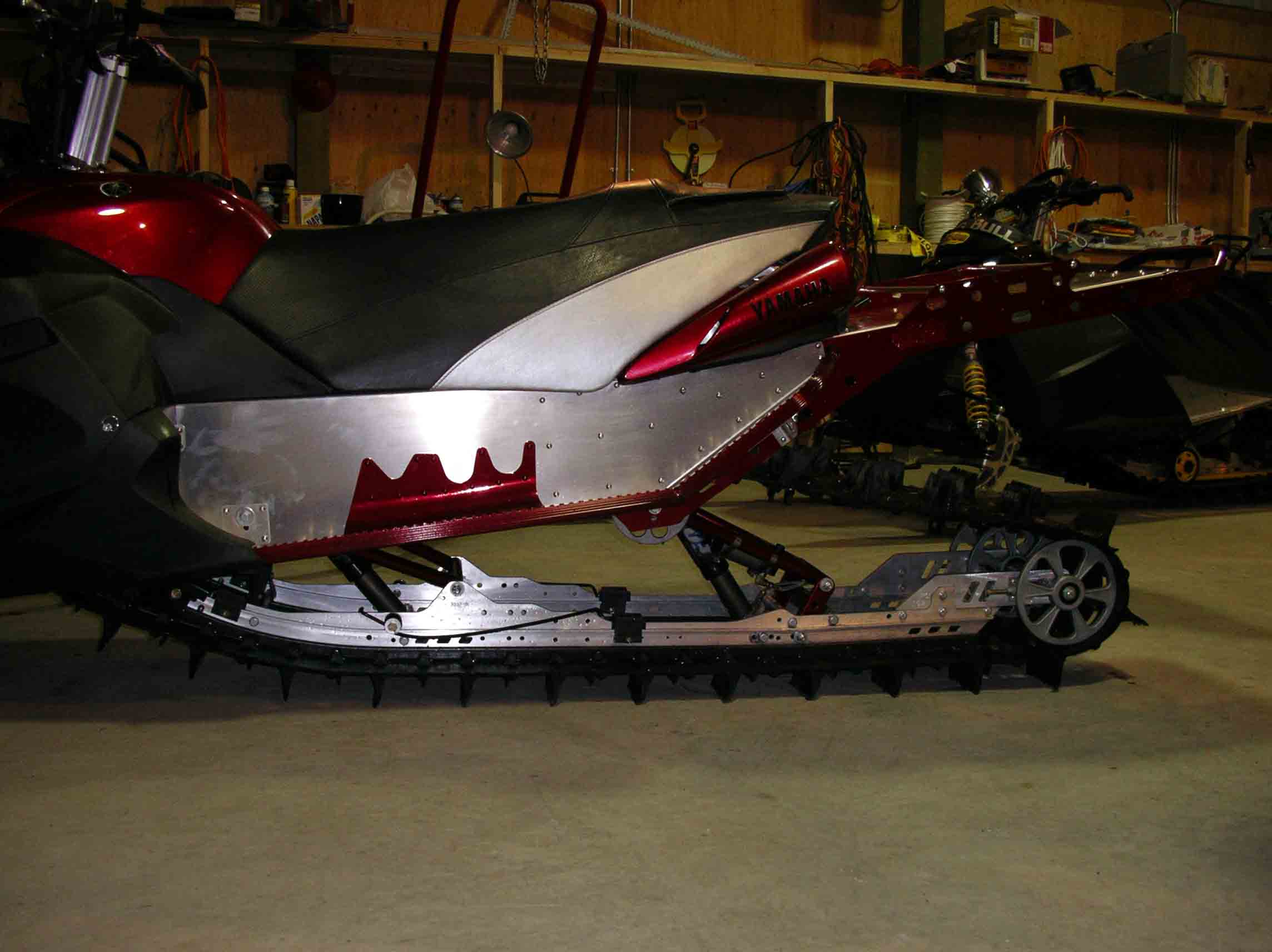

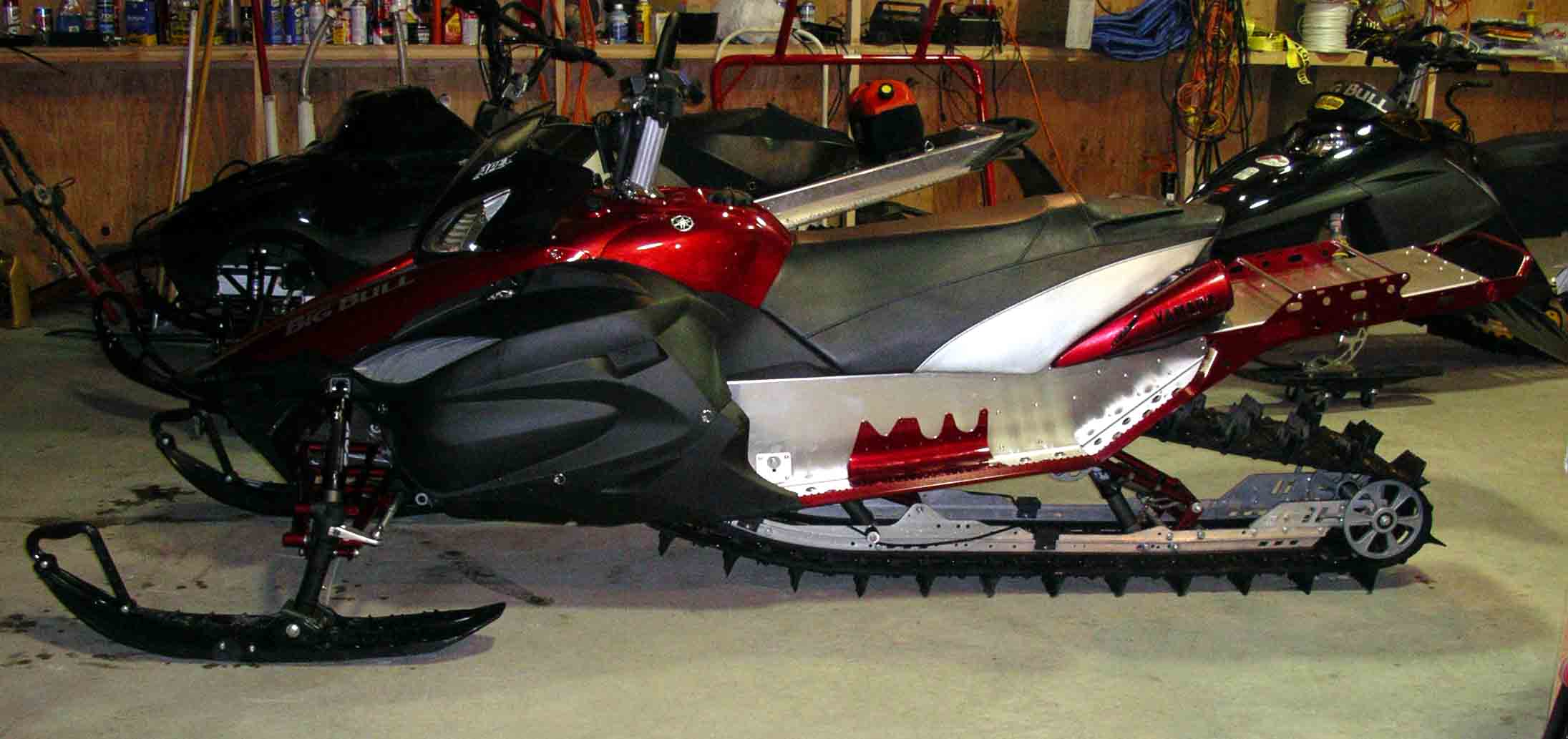

Here is the requested photos. It still needs the Mountain Mod seat installed and my high flow filter installed. I will probably do that next week. Now I am going to ride it!

Man that looks so sweet :Rockon: . so how much weight did it save?your going to have to tell us how it goes . whats the tunnel goign to set a guy back?
I've got that planned for this summer ,looks nice , glad to see he's got a tunnel that works with the rear mount turbo!........How much modding did it take ? Did the side covers require any modifications?
Is that the Fabcraft suspension ? Let me know how it works.
Side covers are a beetch to get back on, especially the right side. But they work. This was going to be a summer job too. Until I had problems with the rear suspension on it the way it was. So I did it now.
As for total weight loss, I will be putting it on the scale next week after the seat and filter assembly is on. I will update the post then. I had stripped about 40 pounds off of it before this. I doubt the tunnel saved a bunch cause I added a 16" cooler to it.
