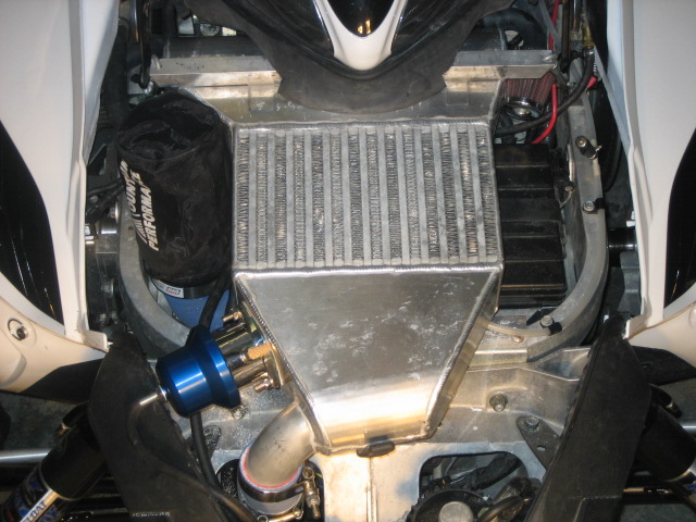

Just got my Vortech BOV from Ted (lightening fast shipping) already had another valve mounted here, so had to make some plastic mods, but it fits NOTE there is no room for weld on greddy mount here, I had drilled and tapped the intercooler and used bolts for mounting studs, mount might not be for everybody but is just another option to get it mounted as low in the I/C as posssible
With just a little imagination, one of these flanges, some aluminum piping, and silicone connectors you can mount your Vortech Bypass anywhere you want to under the hood. I was thinking a 90*, give or take to make it run parallel to the intercooler core, mandrel bent aluminum pipe, welded on the clutch side lower intercooler tank directly across from MPIs charge air tube, and a silicone connector to join the pipe/flange connection. Mounted so that it would place the Vortech Bypass above the battery venting towards the primary clutch.
