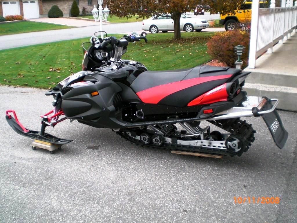

if you want stock size wheels.....go with SPOKED idlers,they are best and cheap.

go to the link i posted above,you will see they are for 97-09s......the 2010 sleds have a 25mm axle,bearings and wheels
the spoked wheels have been around for approx 5 yrs as seen in my pic,they fit my 06 with 20mm axle.
just order the ones you need.....these are from accessory book while 2010s would be a stock idler wheel part number.
Dan
