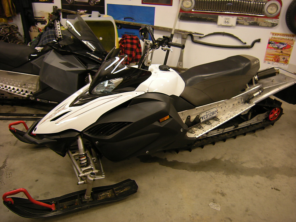

Since track and sprocket is expensive, other part needed for modification was done, at a very low cost. At expense of look and finish.
With stock extension
30 $ extension
Not much room left
no Cost extension modification
Old extension was used for reach the need lenght
Old part again
Almost Complete
Complete, not that bad looking
after some abuse
30 $ extension
Not much room left
Old part again
Almost Complete
after some abuse

Nice looking sled man !

Great work tundra, sometimes one have to choose functionality over looks, you've done a great job re-using parts.
Keep the pics coming.
BTW - could you edit your post to move the pic out to the far right down under (no not Austraila LOL) the other pics. Sorry for beeing picky...

Love the exhaust. Sweet sled Maxdlx
bdm
that is amazing!
nytroERrider
How the f did you do that?!?!?!! that thing looks great!!!
Was it hard to put the apex side panels, hood etc... on the chassis?

Thats nuts man!!! looks like an Apex until I looked at the back of the sled!! Looks awesome man!
nytroERrider
How does that airbox fit? or is that only the top piece of it?
Also how much $$$ are we talking about doing this?

Impressive work Tundra
TT
AWESOME!!!!!!!!!!!!!!!!!!!!! It turned out sweet! Did use an apex gastank also?
If you have more pics of the installment of the apex parts - please post them.
I have to say it again - just SWEEET!

Yes, Apex Gas tank with fuel pump.
i used Rx-1 frame, except for Steering Gate, and bumper attachement part.
New steering linkage, new Apex windshield.
The thing that didnt fit good is the handwarmer, TORS, stop buttons, back alarm.
I used the stock Rx-1 cooling system.
Drag raced all afternoon saturday with about 1 inch of snow, never overheated.
Fuel as been ajusted for the pipe, sled wouldnt run good, CO adjust to 7.
Still have a lean spot, but its over 7000 rpm, i wont be able to adjust that.
Other problem, Speedo come from a short track, calibration is off. I saw 170 km/h with a 162 x 16 x 2.5, thing that is impossible. I dont know how to change that. I checked with my buddy apex, when he is at 147 km/h wot, am at 153 km/h (but only 3/4 WOT
this motor is really strong. Pulling 10800 with 8BU-00 and a good 44-40 helix. Talk about backshift
)this motor is really strong. Pulling 10800 with 8BU-00 and a good 44-40 helix. Talk about backshift

I have started collecting parts - so far I only have the D-frame/steering gate.
Would not the steering linkage from the RX-1 fit or were they changed because you bent the subframe and A-arms?
