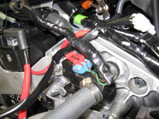

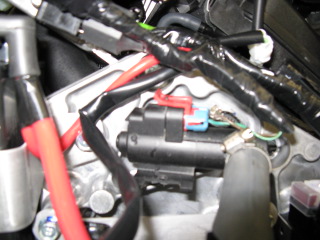

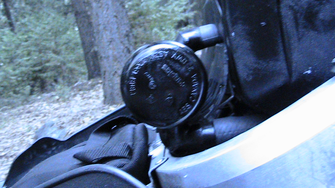

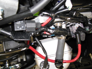

Here are some pics of my set-up. I use a control relay and have it wired so the valve closes when the key is on engine off/kill switch down. When I start the engine it automaticlly cuts power to the valve, which switches it to normal venting mode.
I also wired in a flashing red LED, to indicate whenever there is voltage being supplied to the valve (closed mode). I use it as a warning light, and should never see it flashing while the engine is running. If it does then I know there is a wiring fualt or stuck relay.
