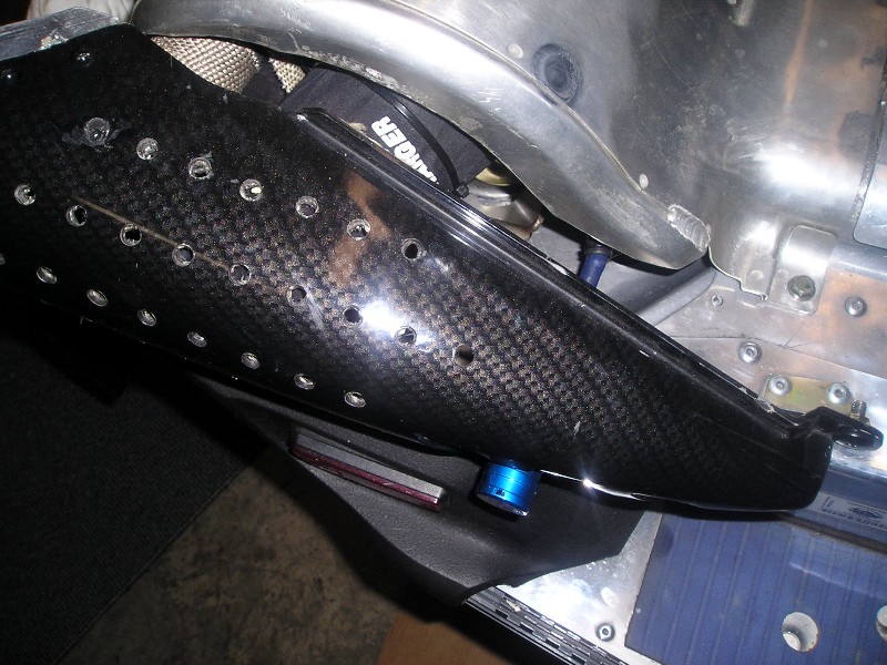

I have pulled the filter on the outside of the exhaust covers on my RX-1 mountain. I just removed the fake exhaust outlet, used a 90degree silicon bend. No more hot and moist air for the engine
Link with pics of the setup:
http://www.ty4stroke.com/viewtopic.php?t=57938
