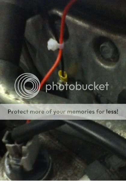

For the ground I picked one of the bolts that secure the oil tank to the sled.
Wire hook up to the solenoid

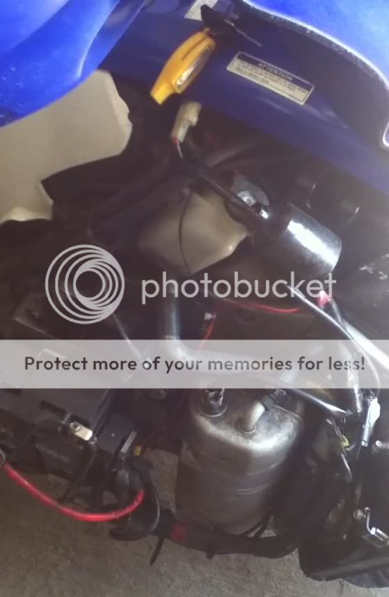

View of the set up
View of the set up
