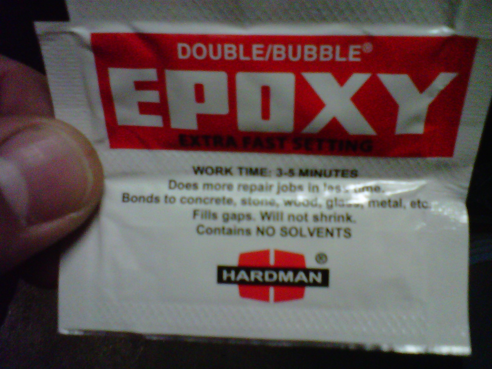

Fine a good epoxy and not JB weld. Both of my apex have done it, I used some stuff from work.

Just found mine leaking in the same place also. Slow drip but enough to create a puddle on the floor. What type of epoxy did you use? Not looking forward to drilling out all those rivets, they will cost a small fortune to replace.
