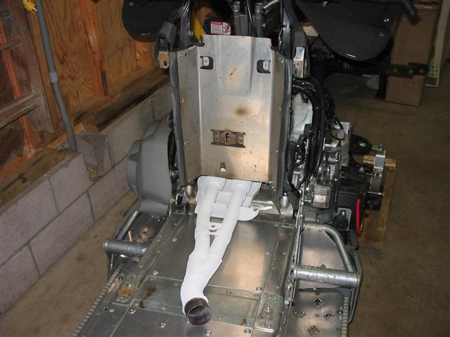

Hey riders here it is my complete exhaust system White Lightning Coated by Swain Tech. Product looks great with awsome workmanship and exactly what I requested. The total with coating and shipping both ways was $220.00 with 2 week turn around. The coating is only available in white but is paintable with high temp paint. I will assemble this weekend with pictures to go along with it.

Here is the install.

Hey Andyfreeze closing off the tunnel will not gain performance with the stock car sized muffler. The restrictive flow from the muffler causes the pipe to glow red hot most of the time. This condition is good for combustion chamber exhasut gases to burn but not flow freely. This is where a new muffler does show some gains due to easier exhaust gases to flow. With a new muffler and less restrictive flow temperature becomes an issue due to easier less resistive exhaust flow.
Take a look at it when your riding at night pretty scary to know it gets that hot. The reason for the coating is 2 fold lower outer temps for gas tank saftey, snow melt issue and contain hotter temps inside pipe for exhaust gases.
