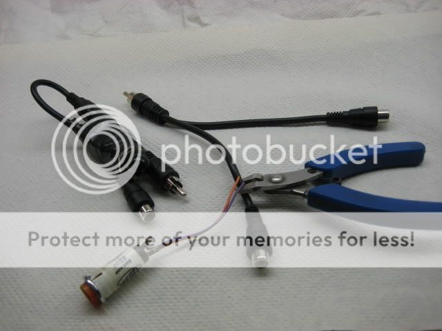

canadianhunter
Finished tester on left, rest is parts to make it.
Use tester alot for on other sledders cords, shields and sleds.
