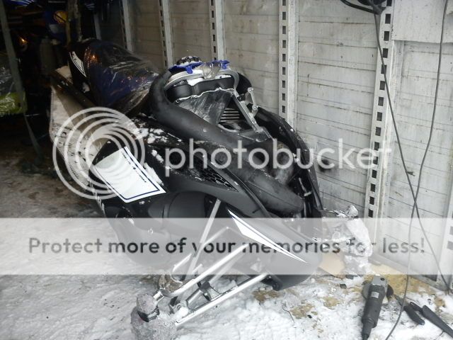

Had some time over yesterday and test-monted the Hauck pipes in the chassie... it will need som fab, but i think it will work.
linemech31
Never will see another like it thats for sure.

Your shop looks a little cold......
Petterssonmotorsport
- Nov 2, 2012
- 56
- 38
sonds said:Your shop looks a little cold......
haha just a little =)
