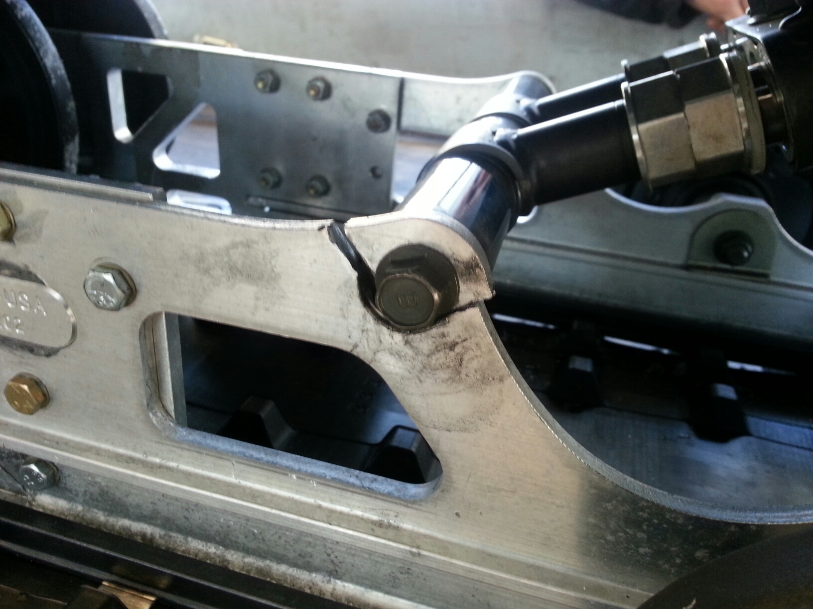

This will teach me to not wait until now to do maintenance on my sled. Bring it in the garage for an oil and filter change, chaincase oil change, replace one of the ballasts for my HID's, then go to lube the skid and I find this... This is the mounting point for the front shock wheels. The only thing I can think of that would cause this is a direct hard hit to break both rails. Anybody else get something similar? Before anybody asks, the wheels are original, not oversized or anything and the low snow wheels are drilled low in the rail so that's not it.

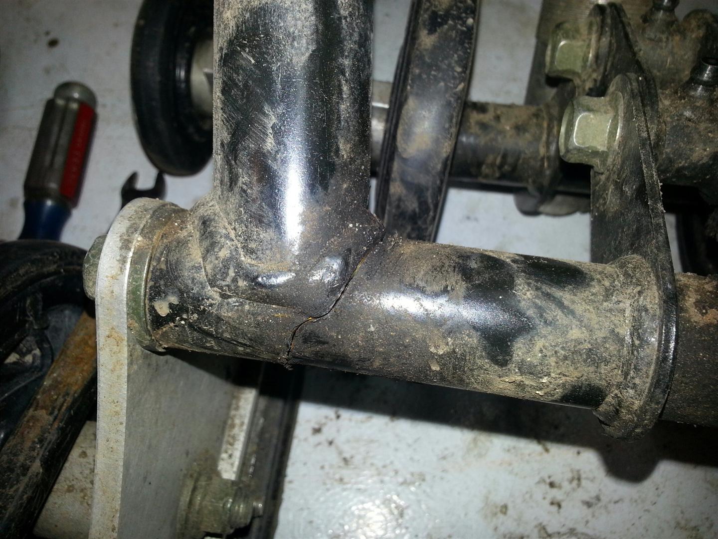

Anybody think that this can be welded? I'd probably get it reinforced at the same time by adding extra material on top of it, similar to what I have seen for the rear of MTX's.

BombaPolaYama
That's a nasty looking break - would have to be reinforced I'd say. I remember having a Ski-doo Formula S break like that and the welding alone wouldn't work. Too bad you're missing some early season riding - not enough snow here and now it is raining!

Yeah, and this was after I had just finished swapping the engine in my son's Doo for the fourth or fifth time (I've lost count) and thought to myself I won't have much to do on mine :-(
I think I found a local shop that should be able to weld it, just the holidays that I'll have to work around with. At worse, I found somebody that's selling parts off an MP in Orillia ON but he doesn't ship so I'd have to go on a road trip and I'm sure it won't be cheap. I'll try calling him later today. New, the rails are $200US each.
Come to think of it, last season was pretty rough with little snow and hard packed icy conditions and I'm no lightweight. The slides are in great condition though with my Doo wheels. If I get it fixed, I'd probably have to remove the low snow wheels there and put in Excell wheels.

pretty serious flexing going on to fatigue the rail like that. probably developed over time, maybe due to suspension bushing wear/slop allowing flexing of the whole skid. bummer....

Well, now I know why my rails broke :-( Seems to be a common problem for Phazers in the first year and I believe they share some of the same parts for the suspension arm:
Hopefully the shop will be able to weld them up and reinforce it. If not, I've got a line on a skid a couple of hours away. Won't know how much he wants for it until tomorrow evening.

Mooseman that looks like some pretty serious repair work. Not sure if it is the same issue reported by phazer owners. I think their issue was mainly the link. The fatigue looks like it is caused by side to side flex/movement. The front of the skid takes all the side pressure when the sled is turning, particularly on hard packed trails. Good luck with the repairs, I am sure a competent welder can do most if not all the repair. The aluminum rails will be the sketchy part of the repair and probably the most challenging to get right.

I wouldn't be surprised if it was the hard packed icy conditions that caused this. It was rough all last season.
I got the parts welded up and it was done well. The aluminum rails don't even look welded and he said they should be as good as new as he welded completely through. He said that the link arm was bent probably before it broke because when he put the pieces together, it was crooked. He jigged it up with the shafts to bring it back straight. The short shaft was bent so I exchanged it with the rear one that was unaffected. I was able to straighten the bent shaft with my shop press to be useable. Unfortunately, no pictures. Too much in a hurry to get it together and enjoy all this snow! I'll try and get some later.
Went for a ride yesterday, riding two-up,checked it after, all good.
edit: Looking at the Phazer link arms and the breaks look the same as mine, even the Z patterned one.

Same thing here my VL has cracks on the rails as well as the H arm near the Upper Front Shock Mount. Last ride of the season we got some air and came down hard. Welded the arm and braced the rail near the cracks. Fingers crossed for the winter.

I would get those welded by a competent welder. I did and he did such a good job, he's confident it's just like new.
After getting mine done and riding two-up for a good while, all's good.
