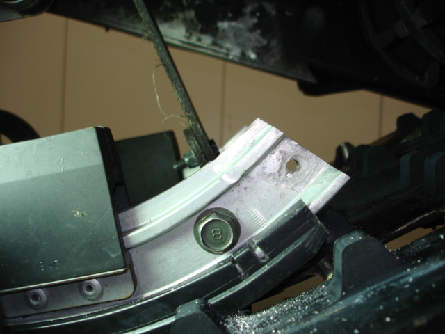

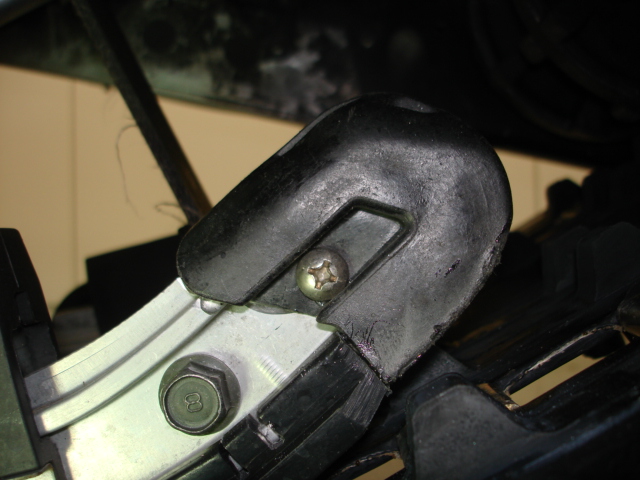

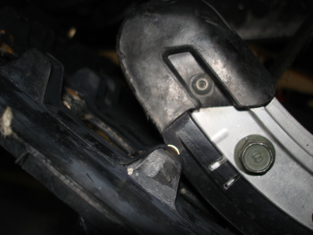

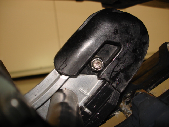

Since I just installed a fully clipped Ice Ripper XT track I decided to fix my loose rail caps just to be safe. They have been loose for most all of the 7200 miles on the sled and never caused any track clip damage on the original track.
When I removed them I could see that they wore down the aluminum rail where they had been rubbing back and forth over the years. I drilled out the holes and re-installed them with 1/4 inch stainless screws and nylock nuts after filling the rail caps with epoxy.
