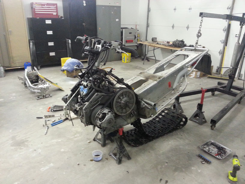

Its mid-February, and here in MN that means the season could end at any time, all it would take is a few days of close to, or above freezing to zap whats left of the snow on the trails. With that in mind, I decided to hold off on the major upgrades and changes to the Phazer until next fall, and just get her serviced and tightened up. I thought I share what is done, or is being done this weekend, and ask you people if there is anything else u can think of that I should do while I've got her this far:
Relocated Speedo/Display
New Exhaust Donuts
Fresh CR9EK Plugs
UP Bushman spindle saver kit
UP Bushman steering kit
Rear Shock Rebuilt & Revalved (softer)
New balljoints (LCA)
Oilite a-arm bushings
New Front subframe (OG had a bit of a bend to her)
Replace Tunnel Block Off (original one was kindd ghetto)
change chaincase oil
change engine oil & filter
Loctite Starter bolts

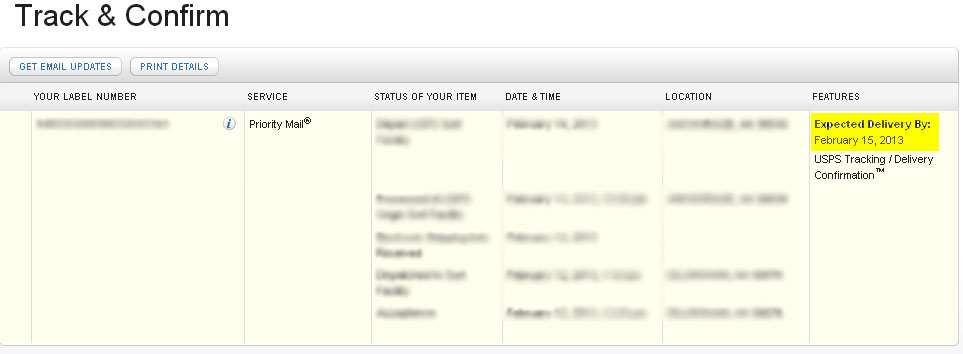

DigitalFusion said:I cant win!
First the control arm situation which delays me to tuesday, now the mail just came and went minus the package with the rest of the parts I was expecting. I guess you cant trust USPS expected delivery dates for priority?
Bummer

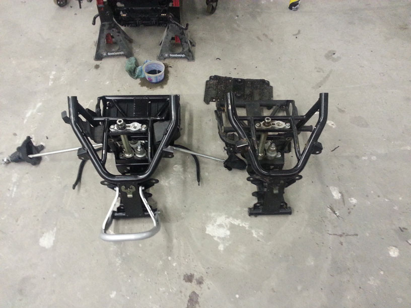

still waiting on the control arms from yamaha dealer, but in the meantime I've got everything swapped over to the new subframe and installed the UP Bushman steering bushing kit. Can anyone tell me if the sway bar ends tip up, or down? I cant remember!

DigitalFusion said:still waiting on the control arms from yamaha dealer, but in the meantime I've got everything swapped over to the new subframe and installed the UP Bushman steering bushing kit. Can anyone tell me if the sway bar ends tip up, or down? I cant remember!
odd, photo wont upload. Too heavy of a server load?
Sway bar ends curve up.
Did you buy a new or used subframe?
