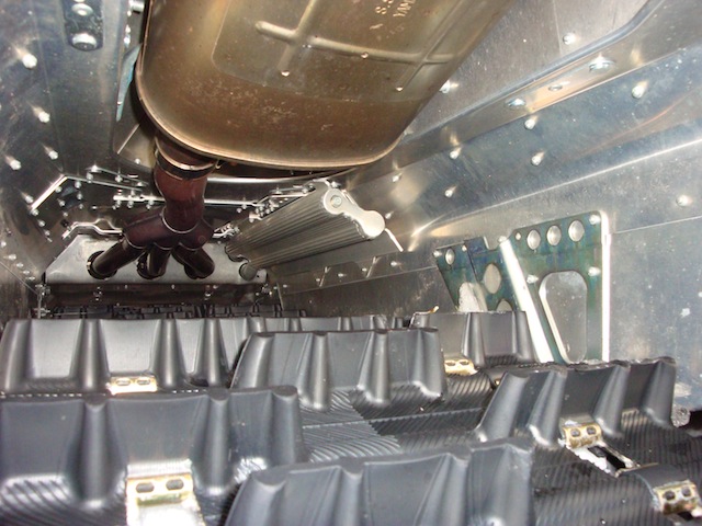

trying to add Pics of guage and cooler.

Thanks for the pics. Is there drilling through the tunnel required for the mtx cooler? I thought there is with roust.
If my memory serves me correct, the hose line holes at the front are already there but you may have to drill out a couple of rivets to remove a dummy plate covering them. Also, a few rivets may have to be drilled out to rivet the cooler in place. Actually, the more I remember, there was a fair bit of dismantling involved to install this, but the included instructions that came with the kit, were good.
It's not hard at all to install..a bit of messing around but very straight forward. 2 rivets for the block off plate and a couple tunnel rivets need to be drilled out and that's it. Then it's just a matter of draining the coolant and replace the hoses...top up the coolant and you're good to go...a couple hours work at best. Mine didn't come with instructions but Ulmer hooked my up and they were very easy to follow. I have an AEM gauge...works awsome.
