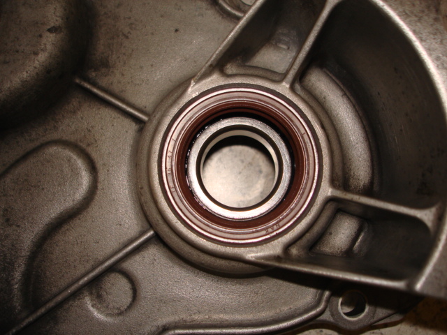

If you change the chaincase oil seals, note that the oil seal in the chaincase cover is special as well. It is a Viton seal that is designed for the higher temperatures that might be transmitted through the jackshaft from the brake rotor. The Viton seal is red in color and costs about three times as much as the two other standard black oil seals.
