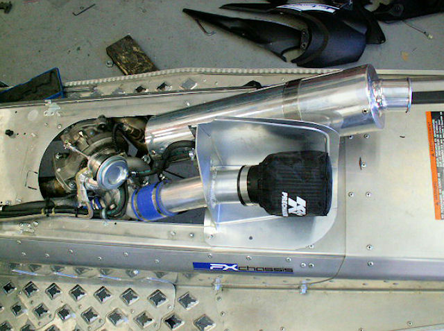

kopenytro
O2
Thanks for the input Snobird.
I have some new details to add.
Since my last post I have purchased an AEM Wideband UEGO AFR gauge - #30-4100.
I also have my exhaust back and am in the final stages of mock up before being sent out to be ceramic coated.
So am I to understand that I can not put the O2 bung into the header pre turbo like originally planned and need to mount it in the can for gauge accuracy?
If so, based on the pic below, can you give me a suggestion for its location.
Thanks for your help and input.
Kope

For the most accurate reading you will want the O2 before the turbo 12-18" away from the spark plugs. This isnt alawys easily done on the nytro so most guys like myself put it right before it goes into the turbo.
I have had mine both before and after(bungs welded in both spots) I see about .5 leaner after the turbo.
Also heat is a good thing when it comes to O2 sensors. The quicker they warm up and stay warm they will live a happy life.
Here is where I mounted mine. 1200 boosted miles and not a single problem.
kopenytro
O2
Thanks for picture and the info.
That is the same route I'm going to take.
Easier and less space restrictions.
Nice to see my header being put to good use!
Always thought you did a great job on your build.
- Mike

SnoBird888
- Sep 4, 2013
- 354
- 27
- 438
- Neenah, WI
- 09 Nytro xtx
In your application it will need to be mounted pre turbo. in applications with atleast 12" of pipe (no muffler) post turbo then put it there. being its on the sled the mounting location is pretty limited. afr should never change across the turbine so post turbo sensor prob was experiencing turbulent flow. it only takes 20 sec for the sensor to warm up. too much heat is very bad for the sensor and its the main reason a sensor fails early.
again your limited to pre turbo so it is what it is and many ppl have done it. miles on a vehicle are different than miles on the sled. I would expect my sensor to last 20+ plus miles were sled guys are happy with a couple seasons. 3k or so miles
