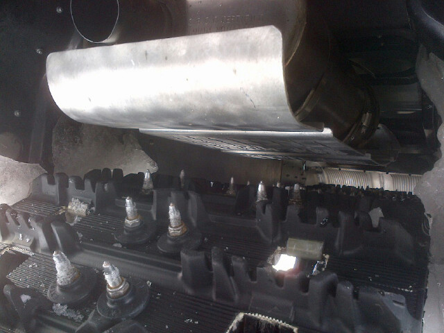

Was that muffler guard homemade or was it something available from somewhere? Could you get a few more pics of it?

I would be interested in seeing a close up pic of your muffler guard though. Is it homemade?

Muffler guard Yes its home made
I get all my metal from the recyclers cheap by the pound I will try and get more pictures I play with the track tension loosen off till it hits then tighten up a turn
