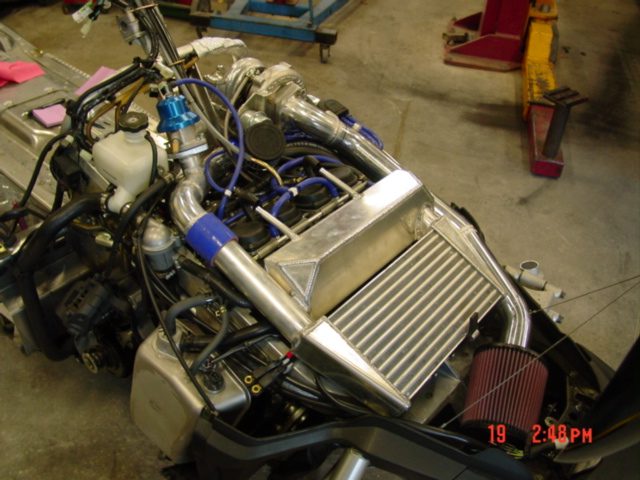

I though you guys might be interested in what I have been up to over the summer, not finised yet still have to install the Excell motorsports exhaust, track, drivers, and my own clutching.
Still in the works need to polish the pipes.
I will be offering my Air intake system and charge pipe with Blow off valve to other NE turbo owners, since this is what they fit.
Have not decided on cost yet but need to find out if there is any interest.
Please email me if interested tedj@jannettyracing.com
If someone wants to bring me there sled with other brand turbo kit I can build similar parts.

Thanks Silver Bullet, Hey My Dad had a Ski Doo Silver Bullet back in 1972 brings back memories of my childhood, I was 8 years old then.
Hey Otis, yeah that is my 04 Warrior, I am keeping it but turning it into a lake racer, I look forward to seeing all you guys again this winter let me know the date when you set it tedj@jannettyracing.com
Dave that header fits like a glove, couldn't ask for a better fit, nice work!
Greg told me you make them.
I decided to take things a bit further and apply my 25 years of car and truck building experience and apply it to my sled.
There are a lot of details you have to really look for in the pics

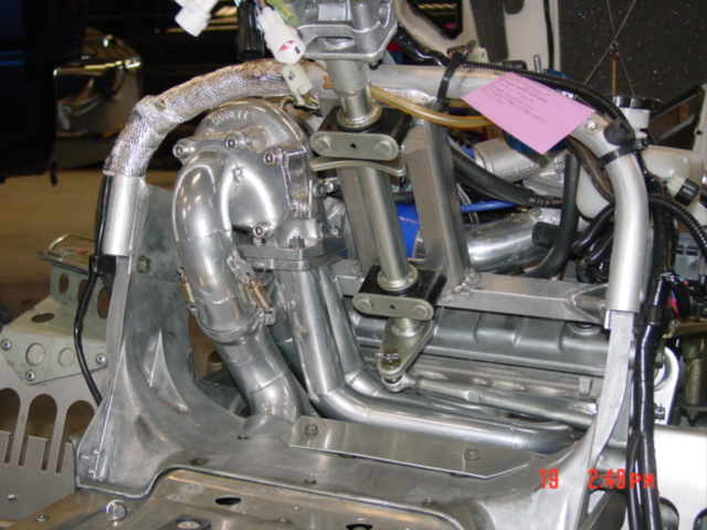

Here is a shot of the two Y pipes, the one on the left is part of the turbo kit, which is designed to connect to the stock or aftermarket exhaust systems
The one on the right is from the Excellmotorsports exhaust which is designed to connect to stock header or Turbo Y pipe.
I figured who needs 2 Y pipes so I cut them off the fabbed up a new pipe to stream line the system

Question though --- what is the black box on the belt guard with the 3 blue lines going into it?
Ted Jannetty
- Nov 24, 2003
- 2,010
- 1,198
- Waterbury Ct.
- www.jannettyracing.com
AHHH! someone is picking up on the details.
That is an HKS electronic boost controller, there is nothing better on the market that I can find other than direct computer controlled wastegate.

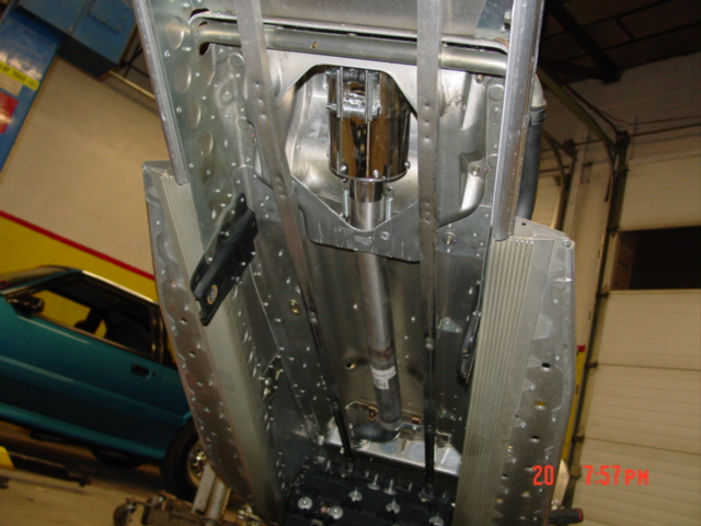

TTT more pics to come, just installed the track and suspension, rear heat exchanger, boost gauge and wide Innovate wide band O2.
Anyone interestested in charge pipe or air intake system?
