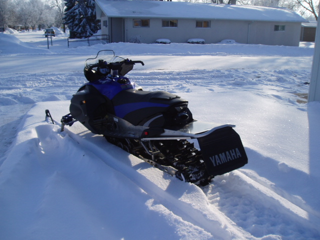

Well what started out as a red 136" Attak has now been upgraded.
-38" Ski Stance
-Excell Exhaust
-Hartman Inc 151" extension kit (tunnel & rails)
-8 tooth extrovert drivers
-2" x 151" Camoplast Series 4 track
-Slydog Skis
-Ulmer Racing modified clutching
The next step is to add a supercharger, but we'll make one trip to the mountains before we do that!
-38" Ski Stance
-Excell Exhaust
-Slydog Skis

Mighty, probably won't be what I'll have in Muni, planning on bringing 2 short tracks.
Eric, I'll see what's going on. Swamped with work right now. I have 3 supercharger installations to do in the next 3 days, busy, busy, busy.
Kb, revelstoke, that's way too damn far away!
Lb, the customer didn't want a 162" track. He wants to be able to ride it in low and high elevation. He told us what he wanted, we built it from there!
