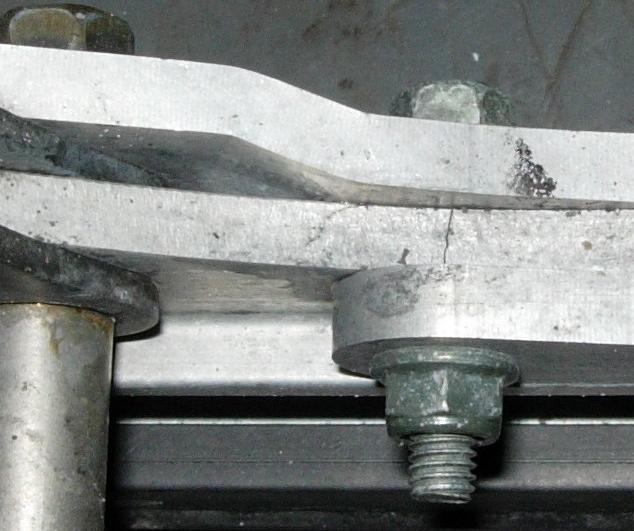

My sled was not fixed last season starting near the end of February due to back ordered slide rails (mine were cracked). I was told Yamaha was not going to install new ones until the new, stronger 2006 rails were available. I ended up missing out on the last 6 weeks of the season.
It turns out the reason my rails have cracked where they did is because they are retrofitted 2005 rails and there isn't near the meat as the 2006 rails where the cracks formed. After waiting 9 months for my 06 rails to appear to get my sled back together they installed the weaker 05 rails anyway!!!!
It has the same cracks in the same locations as my sled. It only has 4500 kms on it.
We're probably going to reinforce both his front and rear arms the same way as mine (instead of going the warranty route followed by more breakage).
One thing I discovered that really pisses me off.
ReX
I just checked the on-line fiche and the 05 rails have been superseded with 06 rails.
(Edit - this is actually incorrect. The rail part number hasn't changed on the 05 skid. IMO, it should have though. The 06 rails are stronger and are a direct bolt in)

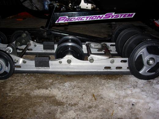

Here are a couple of pictures.
