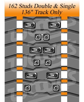

As for pattern, if you DO have an Attack (136" track), then the 144 pattern suggested above becomes 162. Same idea, just more rows. IMHO I would NOT stud on the outside belt. Many people do, but I've seen more tracks tear because a stud pulls through on the outside. This may of course be caused by riding style and conditions. Good Luck! ;)!

you could use 144 studs...(kinda like 96 in a 121) or 162

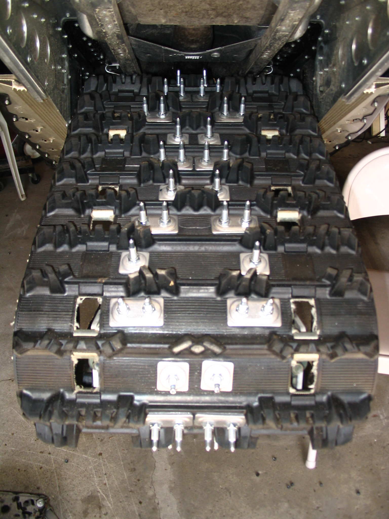

I am running 168 woody's signature series in center only with single and double pattern/ Woody's long track template no.2. I like the stability of the double plates on every other row. I think they are stronger and less prone to pull out under high stress.....
I went with what woody's reccomended which is 1.325 studs. This is what i used to run on my renegade so i expect it will work well on the attack. I ran without studs all last season and it was a joke. The torque just breaks the track free at any speed.....

pic attached

Nice pattern ;)! I've never used the double backers, but have been very tempted. I agree that they are less likely to pull through. The seem to have very little flex and hold very well to the track. :flag:
This is what i run
I run this woodys 162 stud pattern. I use roetin Hornets which are the sharpest stud on the market. I don't run studs on the out side anymore. They tend to pull out and they don't let you puch the rear end around corners
