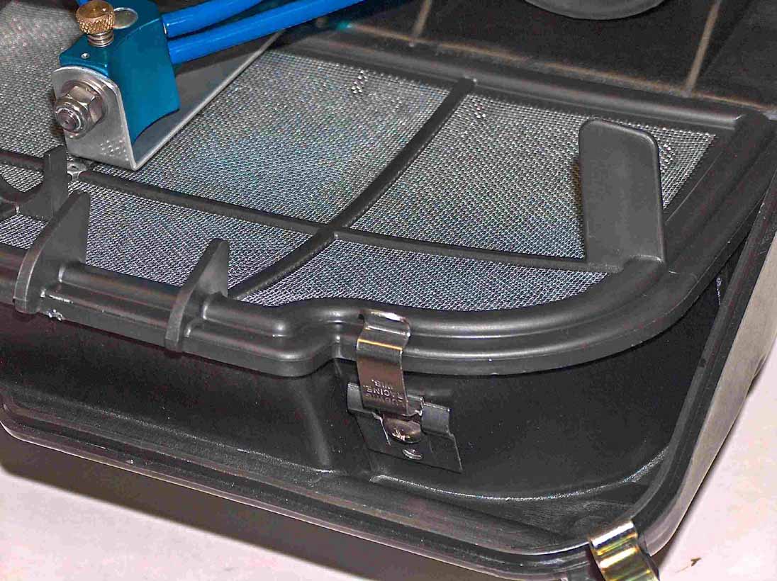

The tube is the crankcase breather tube and yes it does pass oil. As far as cutting it short I am not sure if this will help or not. Steve spent considerable time coming up with a new breather tube configuration on his flow bench. I can try and attach a picture of mine with the new tube installed, also the screen in the airbox would warp out of shape so he added snap clamps to the screen to prevent it from warping.
