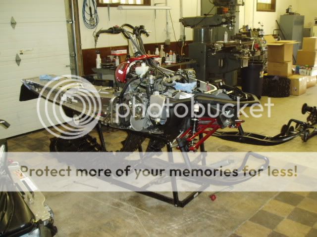

The tear down begins!!
Removed gas tank for high flow header install.
Removing parts for the supercharger install.
Skid removed (installing different track).
Track removed.
Stock header installed.
Muffler protector plate.

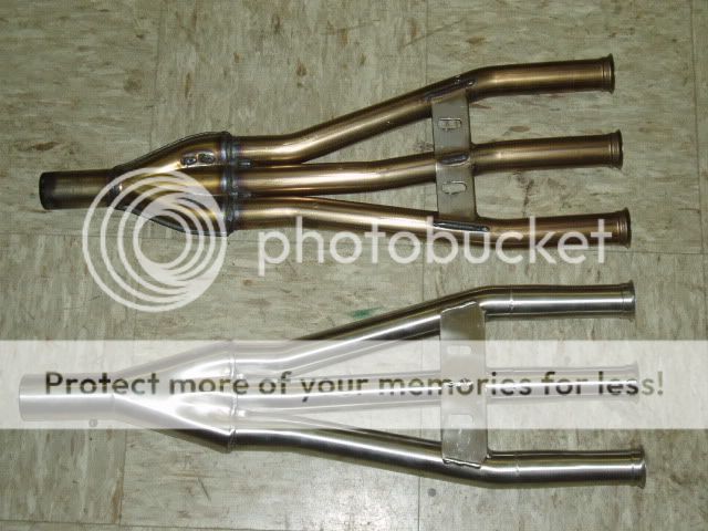

Stock header vs High Flow Header.
High flow header installed.

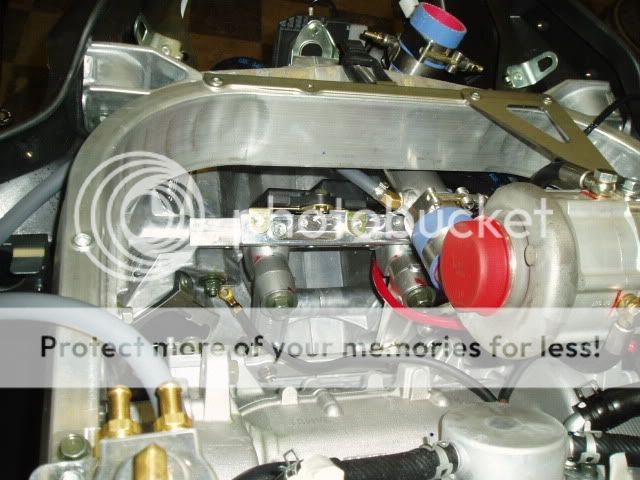

Rest of today's progress. Time to go home for tonight and start on it tomorrow morning! I'm in the process of drilling the pilot hole for the supercharger stub shaft to go through the Delta Box when I realized I didn't have the 3/4" hole saw that I needed.
View from the front.
Fuel System Electronics.
Fuel Return block.
Another view from the front.
Fuel system installed.

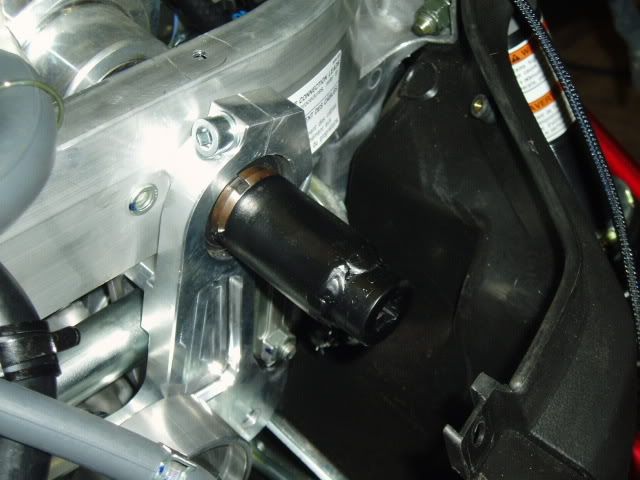

Just a picture of the hole required to be drilled through the Delta Box.
Picture of the special tool you need to tighten the supercharger shaft nut to torque it to 40 ft lbs.

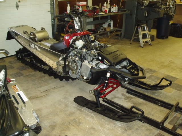

Today's progress.

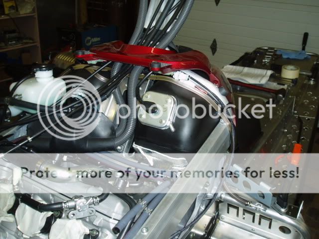

Removing the stock oil can from the air box.
New MPI oil can.
Oil can installed.
Battery, carbs, and air filter installed.
Intercooler installed.
Hood installed.
Airflow to the supercharger oil cooler.
