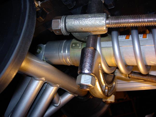

Here is a picture of the spring compressor and bearing spreader installed on the shock (this pic is on the snowmobile when I was changing the c-clip position). You can see two of the c-clip grooves exposed on the left of the cam assembly.
