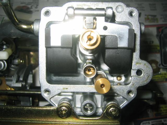

Pull the rack off turn upside down and then remove the jets one at a time from the carbs.

You see the ones in the middle with a regular screw driver slot on them, the little on is the pilot jet, pull it out and see if you can see through it starring into a light. If not its blocked and clean with carb cleaner. It only takes one of them to throw you off so dont look at one and if its clean assume they all are. I pull the main and pilot jets and spray them clean then blow dry with a air compressor. Its easy after you do it once.

Dan, Kinger has some great pics for you. This is what it sounds like to me too. However, I had used stabil for the storage back then, basically all you can do is drain the float bowls after and run it out of gas to prevent the needle jets from plugging. So, yes, I've had to do the same, but only one pilot was messed up. Tom walked me through it on the phone.
The toughest part of it all is getting out the toughest little flathead screws that you're ever going to find at the bottom of the carb bank. Go get some allen heads from Fastenal or something to replace them out. 16 of em. If you ever have to do it again, well you'll see.
Kinger - great job, glad you took pics and were able to post, cuz this isn't the easiest thing to do.

thanks for the photo, I've done this before when I installed the ECP kit. so you guys are sure its not the TORS?
