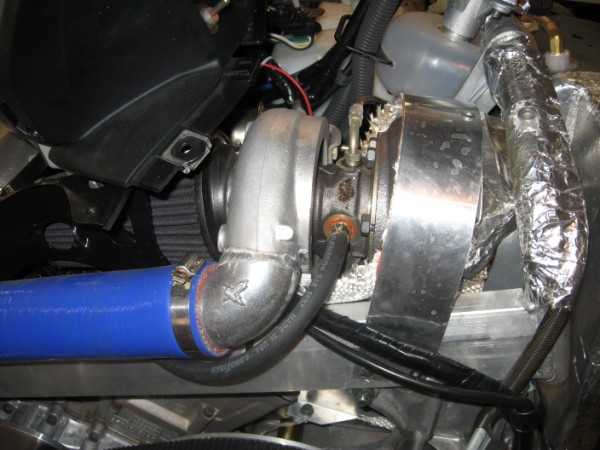

Well its been a few tough weeks here, between holidays, the wife's birthday, which we treat as a holiday, and my Mother-in-law going to the hospital again with a scare, I finally got the first production kit going on the dyno yesterday. Sorry it took so long, but family does come first. I have made some slight tweaks to the baseline kit. They are as follows. CPR heavy duty head stud kit, 3-stock Apex gaskets for a total gasket stack of .051" thickness. A Vortech bypass valve ,Thanks Ted, and some additional odds and ends as additional insulation in the heat chimney and the relocation of the oil drain-back from turbo the valve cover behind steering crossmember. Nothing major just wanted slightly more power with pump fuel. I just want to say that the fit and finish is excellent. These EFI machines don't leave much room, and Jeff did an awesome job getting everything just right. Now the power. All I can say is it is very impressive. Fourth pull on a brand new engine, 0 miles, and it went 264 HP and change, backed up with 4 more heat soaked runs in the 264-259 HP range, back to back. This is at 11.8 lbs of boost. Track dyno on the first pull was 144 HP and hitting rev limiter. Adding and juggling weight to CPR super-tune kit, helix and spring twist changes, netted us 148-150 HP to the track, again with 6 consecutive heat soaked pulls. On the track dyno it would only show 11 lbs. boost. Few items of interest, Cyberdyne digital boost gauge is extremely accurate, showing boost in tenths of a pound, it however is slow reacting to dyno, or std. dial gauges, which is fine for trail use anyway, as all you are doing is checking boost. Heat coming off heat vent is very minimal. Water to turbo housing is working great. Not too much, not too little. This machine turned out awesome, I'll take some pics later too detail a few things, I'm extremely pleased the way it turned out. Very happy with the way gauges and mounting worked, also the custom rear cooler I added. Heading to the UP next Wed. More pics and details to follow. I need to get out and change oil and filter and wrap it up. Mike Knapp#17

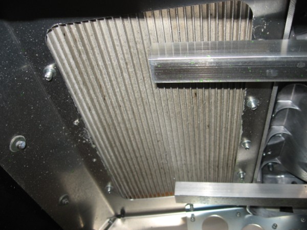

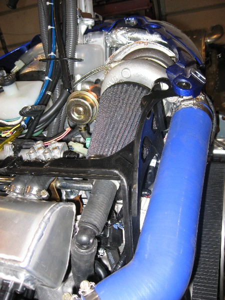

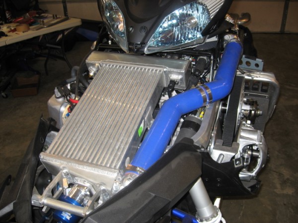

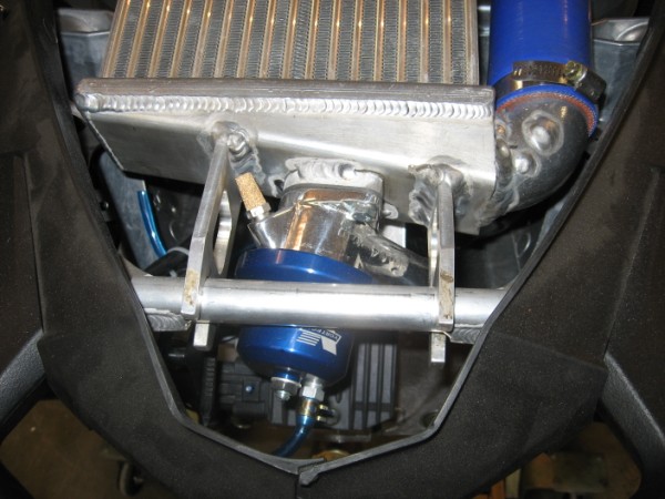

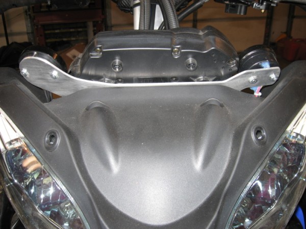

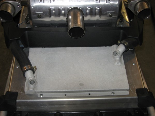

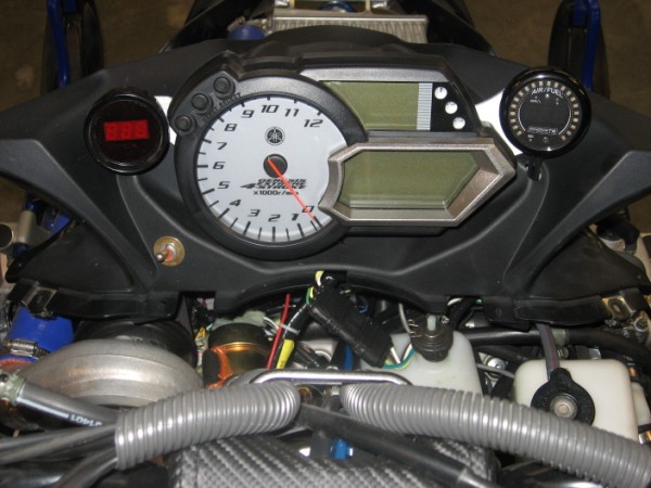

A few pics, note I also changed air filter to a K&N type. Also custom built gauge holder and rear cooler that takes no tunnel clearance.
