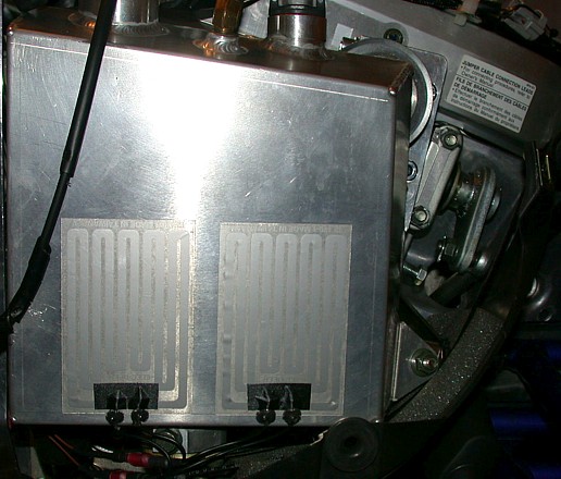

Supercharger lines, intercooler fan, N20 system, Pre-heaters, OptiMate III battery lead, probably added 5lbs in wiring and ny-ties alone. I'm scared to weigh it...LOLDang, you just keep adding weight onto that thing!

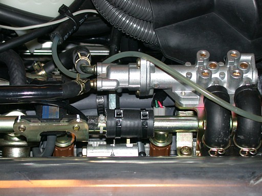

They sell a 110V-AC in-line coolant heater.
SMA-HEATR-CL-NT...........$30.95
Fits '94~'02 liquid-cooled twins, all 4-stroke models
But I would need 60-miles of extension cord......
The way I have it setup now, I can use a battery or my tow vehicles 12V-DC.
