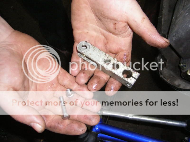

take the new sway bar and the arms and put one on lining up the index mark.heres a pic of the index mark.
the arm with the index mark.

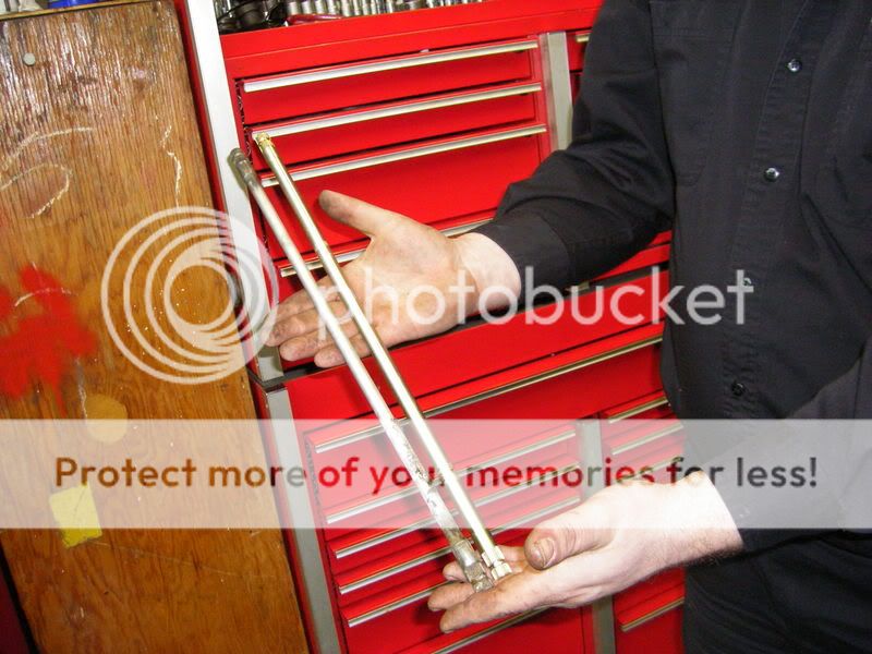

tools: sled support, 12mm socket/ rachet and 12 mm wrench i used two 10mm wrenches.
