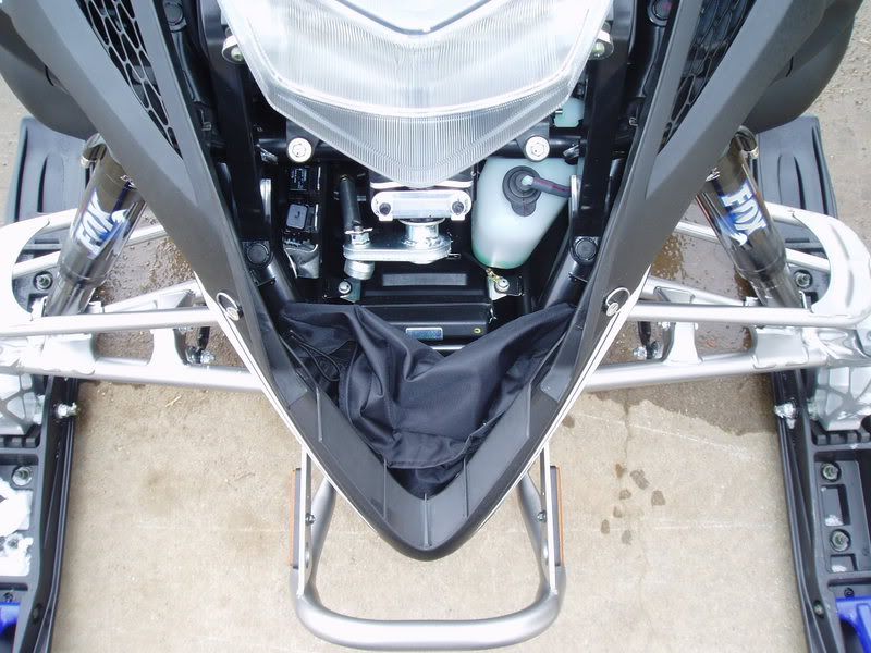

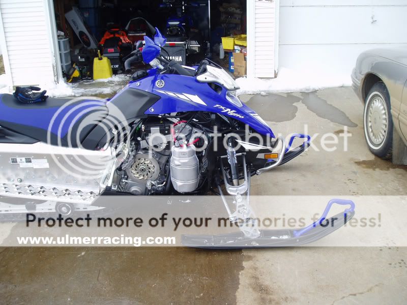

Here at Ulmer Racing we were given the oppurtunity to take an inside look at the new FX Nytro! Yamaha did a great job at giving us more room and easier access to the normal every day parts! By removing the three (3) main body panels you can get to any of the general maintenance items on the sled without any hassles!
Hood Removal:
To remove the hood there are a total of four (4) ¼ turn dsuz fasteners that must be loosened allowing removal of the hood. There are two tabs that must slide out from under the gauge cluster allowing removal of the hood. After removing the hood there is access to the coolant level, overflow bottle, storage, and spare belt area of the sled.

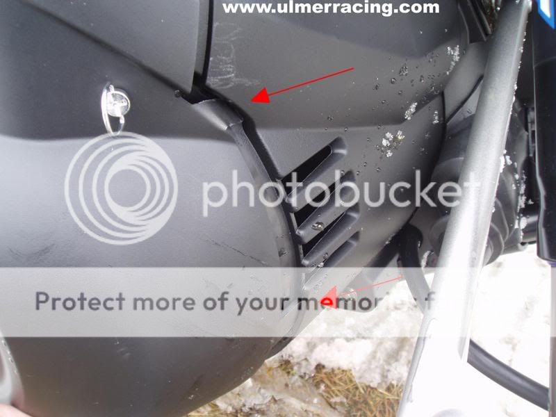

To remove the side panel there are a total of five (5) ¼ turn dsuz fasteners that must be loosened allowing the removal of the side panel. Also on the front of side panel is two tabs that must interlock correctly with the belly pan before the side panel can be fully installed onto the sled after removal. This is also true for the rear of the side panel by the gas tank with a tab, which must be latched as well. After removing the side panel you are allowed access to the battery, chain case fluid, and engine oil.

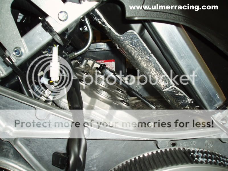

To remove the side panel there are a total of five (5) ¼ turn dsuz fasteners that must be loosened allowing the removal of the side panel. Also on the front of side panel is two tabs that must interlock correctly with the belly pan before the side panel can be fully installed onto the sled after removal. This is also true for the rear of the side panel by the gas tank with a tab, which must be latched as well. After removing the side panel you are allowed access to the primary clutch, secondary clutch, and spark plugs.
