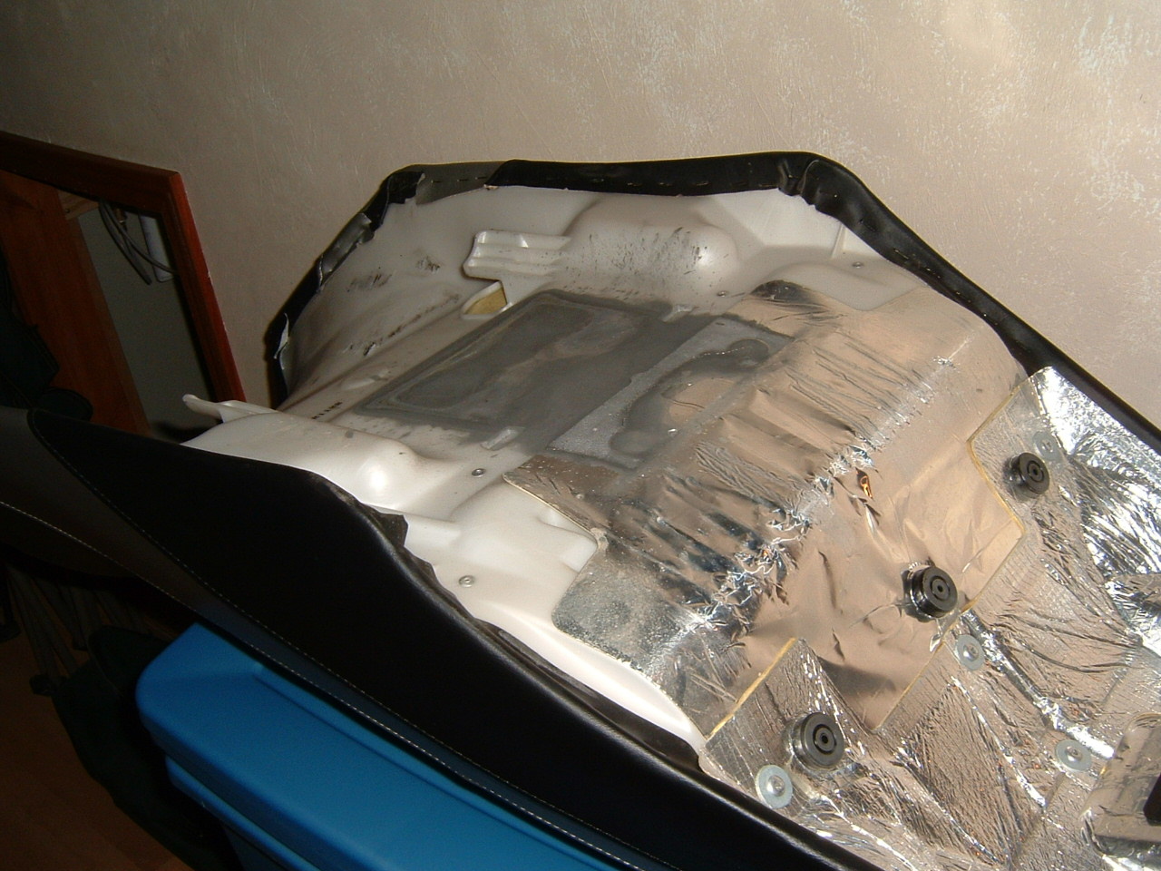

Does the stock seat have a full length plastic pan? Side to side, front to back? I'm talking with a cycle seat company about making my Apex seat firmer, and they want to know about the pan. I don't want a Boss, because I like the oem rear stoorage.

Dan or anybody else. Can you tell me how the seat pan is shaped? Is the pan upswept at the rear? Is the stoorage area a full 4 sided box or is some of the foam exsposed in the stoorage area? I can't look at mine for a while. I had stomach surgery yesterday and am out of working order for a while. The seat company is asking me this. Thanks, rr.

Here are some pictures of the seat pan, the storage area is a box in the plastic pan, plastic on all sides.
Scott

Great pics Wizard. They are a big help. A few more ?'s to you or anybody. The cover is stapled on correct? Does the cover come right off once the staples are out, or is there any type of retaining it to the upward slant of the box front? Like a flap of vinyl with a retainer or a strap sewn to the cover with a retainer. I'm asking all this to get more info to the seat modding company.

No retaining ring that I could find, all staples. Looks like anywhere from a 1/2" to 1" worth of extra material just rolled over the edge and stapled all the way around.
