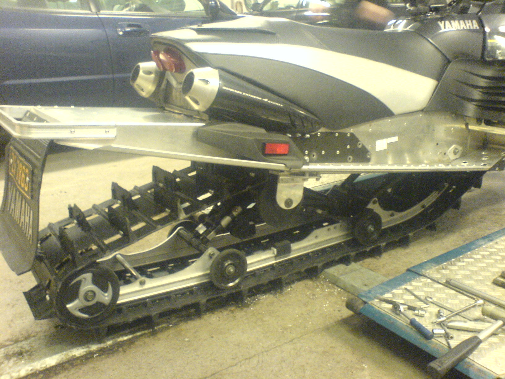

I'm very pleased with my promountain apex skid frame on my '03 RX-1. Not hard - just work :exc:
Now the sled finally transfers. You also loose some weight with the mod - both on skid and dropbrackets. It's more weight to loose if you go the with a AC m7 skid frame.

I have template for apex mountain skid frame. I used Timbersled dropbrackets

Heres is a link to my templates (apex mountain skid frame)- hope it's helpfull. It worked perfect for me.
Double check my conversion from mm to inches if you use it. We use metric system.

If I was you I would use or make dropbrackets thats makes it possible to upgrade to a 16" track from the start. The bolts in the chaincase could be done later if you deside to upgrade to a 16" track.
If your skidframe is to narrow just make some spacers and longer bolts to make it fit.
